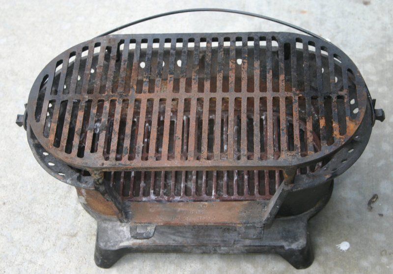

My experience with grease is with a bunch of cast iron pans I've restored. I did this crusty greasy hibachi without precleaning and it came out grease free and uniform.
As purchased from craigslist

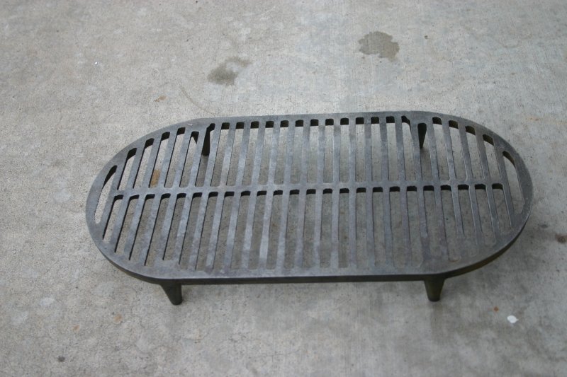

Out of the electrolysis bath, brushed clean and washed. This is bare cast iron.

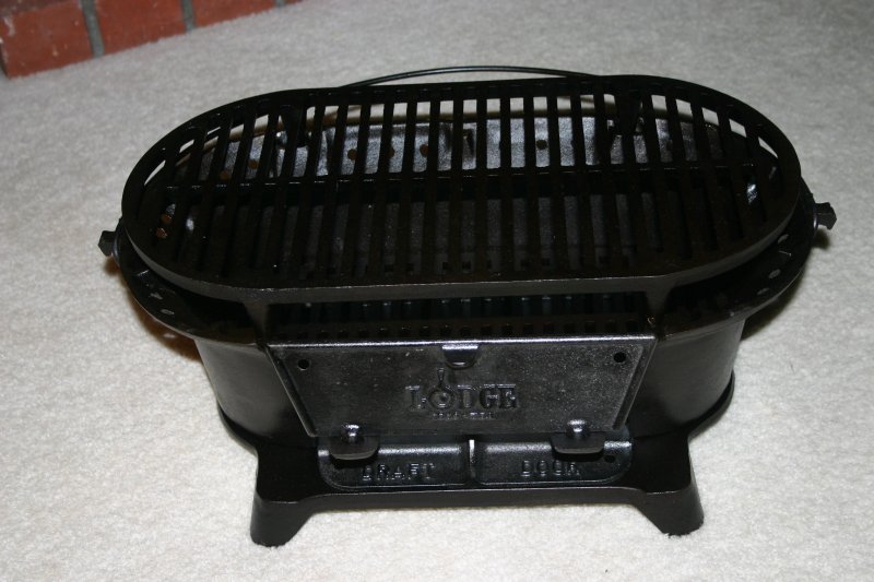

After high temperature seasoning with Crisco. Still bare cast iron but now with the black petina from the carbon in the oil bonding to the iron.

I've seen several sites on electrolysis that says to wash the parts to remove dirt and grease but from my cast iron experience, I have to say that it was removed by the electrolysis process.
