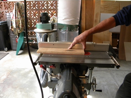

I have the HF model and it works well for me with the standard bag. My shop in AZ is partly open so a few fine bits that may escape (but don't seem to) the standard bag don't bother me. I added a home made cyclone and only the finest dust (sanding dust size) even makes it to the lower bag. It will be a long time before I have to empty it.
[ATTACH]8879[/ATTACH]
Paul M
shipwright wrote:I have the HF model and it works well for me with the standard bag. My shop in AZ is partly open so a few fine bits that may escape (but don't seem to) the standard bag don't bother me. I added a home made cyclone and only the finest dust (sanding dust size) even makes it to the lower bag. It will be a long time before I have to empty it.
Paul M
Is it accurate to say: You have the 2hp HF DC , but have modified the setup so as to have a cyclone prior to the 'blower' as well as the one included after the 'blower'?
shipwright
Posts: 1165
Post by shipwright »
I don't consider the "included" one as much of a cyclone actually. I usually think of a cyclone's purpose in a DC system as saving the impeller and depositing the chips in an easy to empty separate container. You are right however, the stock model does swirl the dust, chips and stuff around.
Paul M
shipwright wrote:I don't consider the "included" one as much of a cyclone actually. I usually think of a cyclone's purpose in a DC system as saving the impeller and depositing the chips in an easy to empty separate container. You are right however, the stock model does swirl the dust, chips and stuff around.
Paul M
I assume that swirling causes the heavier particles to fall into the bag. That is the purpose of a cyclone(the heavier stuff is separated from the lighter stuff(air).
I agree it doesn't look like much of a cyclone to me either(no decreasing radius cone[that is what makes the cyclone 'work']).
