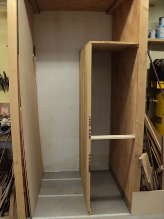

This photo is in another thread, but it shows the UHMW slide bars I have in my plywood rack. They make putting full sheets away and taking them out much easier - and there's no "catching" at all. In the saw situation I would run a strip along the length of the bottom support.
[ATTACH]10418[/ATTACH]
Paul M

Now THAT is a slick idea!:cool::);):D
