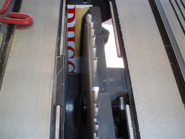

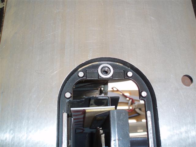

Why is there a dsut collection problem?
I have been working on this problem for a while but had slacked off some. Mark reignited the challenge and I have done a bit more toward an improved dust collection method.
Why dust saw dust escape. Take a look at just a couple images and you will see. These photos are were taken with the Mark V ready to make saw dust.
[ATTACH]9451[/ATTACH]
[ATTACH]9452[/ATTACH]
[ATTACH]9453[/ATTACH]
[ATTACH]9454[/ATTACH]
- P7010028 (Small).JPG (43.65 KiB) Viewed 4338 times
- P7010023 (Small).JPG (48.41 KiB) Viewed 4337 times
- P7010027 (Small).JPG (45.45 KiB) Viewed 4336 times
- P7010026 (Small).JPG (45.96 KiB) Viewed 4336 times

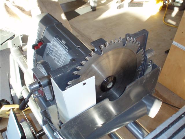

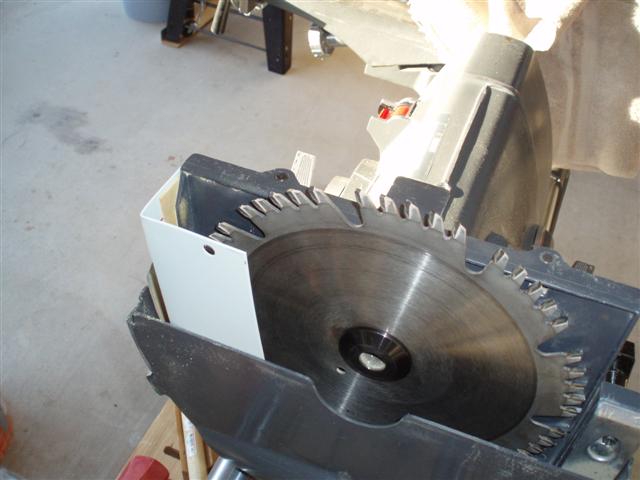

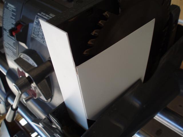

A little challenge

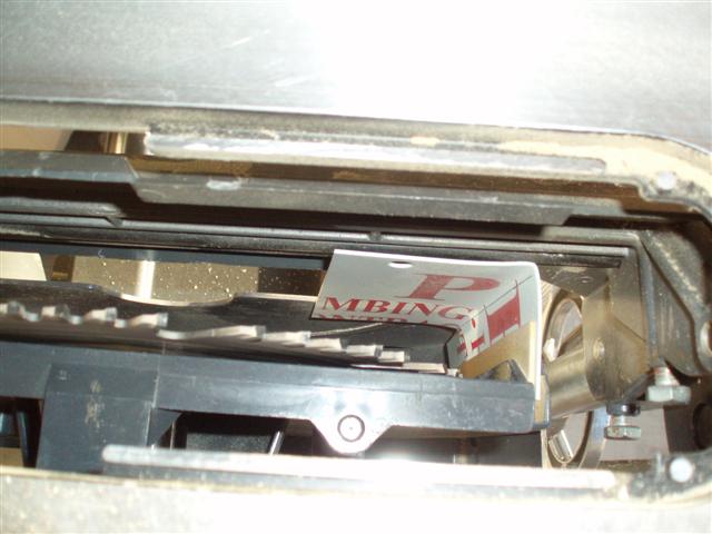

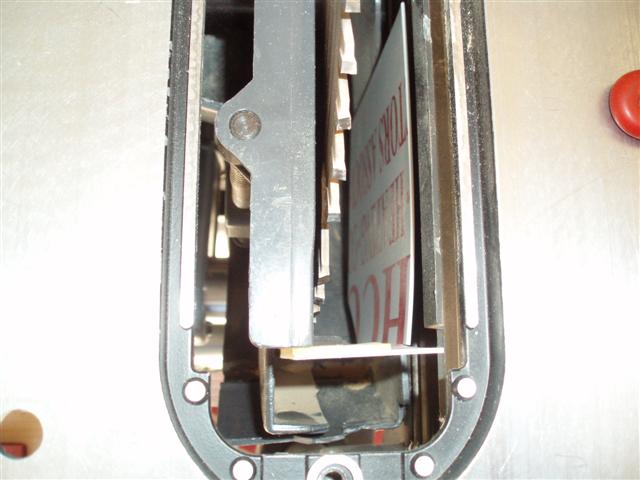

To reduce the amount of escaping dust, I cut and installed a reflector that I inserted into the lower saw guard. The vast majority of the saw dust escapes at the infeed edge of the lower saw guard. You can see that area in one of the previous four pictures. These shots were all taken with the insert removed, looking down through the insert opening. Notice how much of the floor and the Mark V under carriage can be seen (through the dust collector).
I have installed a dust deflector that keep some (most all) of the saw dust from escaping through this area. The saw dust is simply held within the lower saw guard so the the DC air stream can collect it.
[ATTACH]9455[/ATTACH]
[ATTACH]9456[/ATTACH]
[ATTACH]9457[/ATTACH]
The final configuration.
The first two views in this thread simply show where the deflector is mounted. I changed its size and shape on the run.
One other thing that I plan to do is revise the saw insert to occupy some of that space below the insert. This will lower the under table surface so that there is less space between the lower saw guard and the table. The more that dust cannot escape the more dust will be collected by the DC.
- P7010024 (Small).JPG (53.35 KiB) Viewed 4336 times
- P7010025 (Small).JPG (43.11 KiB) Viewed 4336 times
- P7010029 (Small).JPG (35.15 KiB) Viewed 4332 times

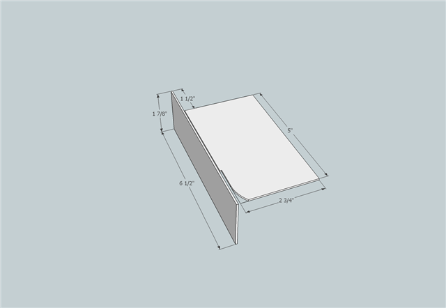

If anyone is interested, here are the dimensions of dust deflector that I now have installed. It is cut from a piece of plastic like material that is very flexible while at the same time remains flat if no pressure is applied to it.
[ATTACH]9469[/ATTACH]
- Dust Deflector 2 (Small).png (31.41 KiB) Viewed 4315 times
