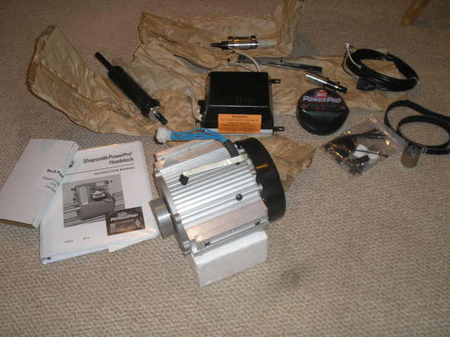

Here are some pic's of what came through FedEx today. This is the self-upgrade option.
Just Unpacked:
[ATTACH]10271[/ATTACH]

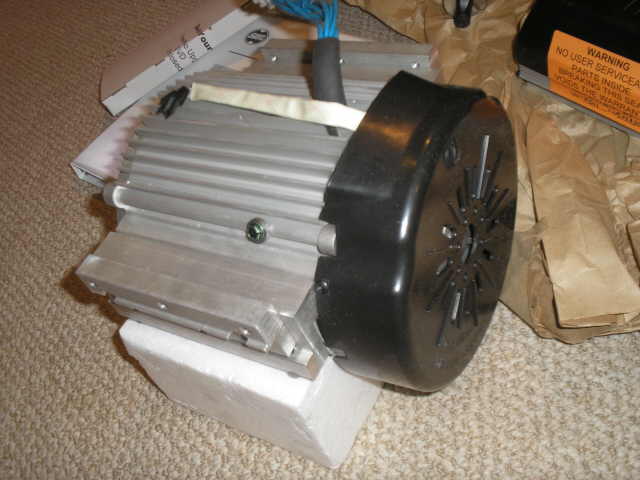

BIG Motor, with Fan opposite from the Belt end:
[ATTACH]10273[/ATTACH]

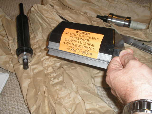

Power Electronics Module (will mount in middle of machine):
[ATTACH]10275[/ATTACH]

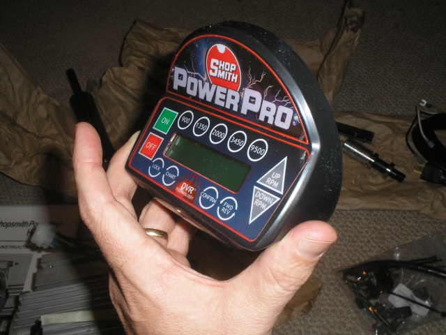

Control Panel. The PCB on it definitely says Teknatool:
[ATTACH]10272[/ATTACH]

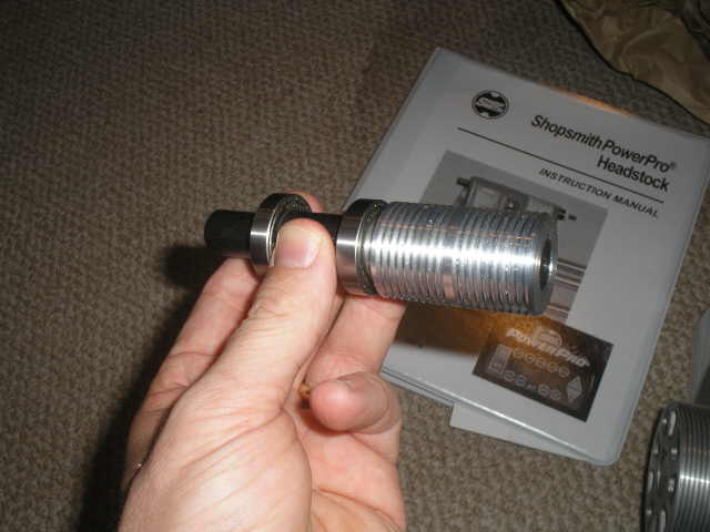

'New Design' Idler pulley/bearing assembly:
[ATTACH]10274[/ATTACH]
Just Unpacked:
