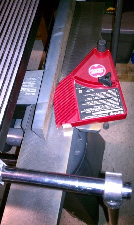

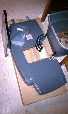

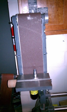

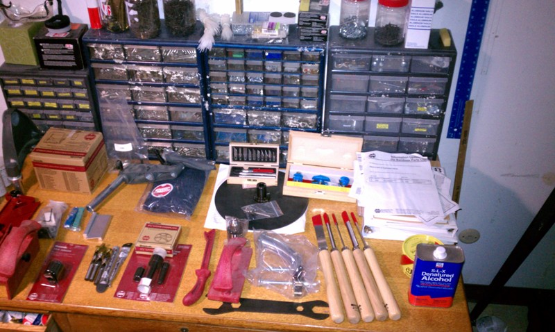

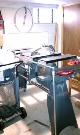

Hello All,
Attached, hopefully, are several pictures of the new 520, or pro as it was listed in the manual with 520 crossed out.
I had to basically assemble everything as it was all still new and in the plastic. Everything that came in the box was also quite a bit. I have a picture of that all layed out on the table. The little extras I didn't know about were great like the 5/8th saw arbor, live lathe end or whatever it was called, the router attachments / guard and head, and all of the lathe duplicator cutters
I was definitely tickled pink
[ATTACH]12405[/ATTACH]
[ATTACH]12407[/ATTACH]
[ATTACH]12408[/ATTACH]
[ATTACH]12409[/ATTACH]
[ATTACH]12410[/ATTACH]
You certainly should be pleased. The price you paid for the entire package is about what I paid over two decades ago for just the Shopsmith and you have a 520 besides.
Congratulations. Please read the instructions, safety warnings before doing very much and take your time doing a complete alignment.
Even though it is new, a complete lub and wax job is also in order.
Care for it and it will be working for you the same in 2100 as it does now.

Thanks for the advice Dusty,
I have actually done the lube of the headstock. I still need to wax the way tubes and lubricate some of the accessories.
I spent an hour yesterday aligning the bandsaw table, blade, tension holders, and guides. I put it on my 78 shopsmith and it ran great. Other than testing out the torque on the new shopsmith by cross cutting a 2x8, I haven't used it for anything yet.
My next step is to maintenance the jointer and try it out to ensure I am getting a square cut and the blades are all evening aligned.
One step at a time but it is coming out great.

P.S. Is that a 'coupler' setting on top of what appears to be a lathe spur drive and tailstock dead center arbor 'kit'?

It is not a coupler. It is called a live center. It is for the tail end of the lathe and it has a ball bearing center which allows it to spin freely at the same speed as the lathe. This is recommended for the lathe duplicator and to be honest, if I had known it existed before, I would have bought one. This makes the loud squeak go away when the wood heats up. That is reason enough to get one :)
spiderclimber wrote:It is not a coupler. It is called a live center. It is for the tail end of the lathe and it has a ball bearing center which allows it to spin freely at the same speed as the lathe. This is recommended for the lathe duplicator and to be honest, if I had known it existed before, I would have bought one. This makes the loud squeak go away when the wood heats up. That is reason enough to get one :)
I see that now. The white whatevers on each end had me cornfused! BTW the lathe duplicator should have an extender that fits on it to make it longer. It goes between the larger diameter bearing housing and the m2 taper. The live center unscrews and the extension screws it back together.

Thanks, I agree with deal I got. I have been trying to figure out how to fit it all in the shop now. Having a basement that is limited makes it fun to fit two shopsmiths in. I am now getting rid of several of the extras so I can fit everything in. :)
