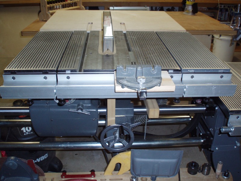

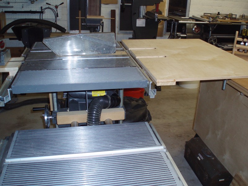

To deal with your issue, I use floating extension tables on both sides of the main table. Doing this allows the extended main table to all be adjusted simultaneously.
However, this can introduce a problem not previously discussed.
Too much weight on the floating extension tables can overcome the table tilt lock. If this happens while performing a cut, it could degrade into a safety issue.
When I setup this way, I use the adjustable table legs (attached to the extension tubes). This stabilizes the main table and eliminates the propensity for the main table to tilt.

Ask and you shall receive. I have attached photos for the 520. The same setup can be done on a 510. I don't know how or if this can be done using a 500.
[ATTACH]12484[/ATTACH]
[ATTACH]12485[/ATTACH]
[ATTACH]12486[/ATTACH]
Some folks complain about the Shopsmith table being too small. I certainly do not have that complaint about the 510/520 tables.

dusty wrote:Ask and you shall receive.
Thanks Dusty...nice extension table too! Did you make that from some available plans?
