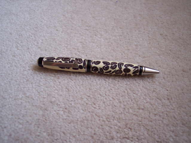

Here's one of the 'gimmick' materials from Penn State Industries, the coffee-bean blank :D . Actually it smelled great while turning! Unfortunately my "go-to" finish, Shellawax, totally obscured the natural smell for a long time. Just lately my wife says it's starting to smell like coffee again.
[ATTACH]13821[/ATTACH]

Chris, the Coffee Bean pen looks great. I've seen that blank in their catalog for some time. How bad was it to turn?

tom_k/mo wrote:Chris, the Coffee Bean pen looks great. I've seen that blank in their catalog for some time. How bad was it to turn?
Thanks! It's been a few months back, so I'm just going by memory now. I know I had a couple of the coffee-beans chip-out during the turning. So I super-glued some of the dark dust into those voids. I think my overall impression was that making one of these coffee-pens was enough for me. (As opposed to a nice hardwood pen, which I'll do again and again.)
