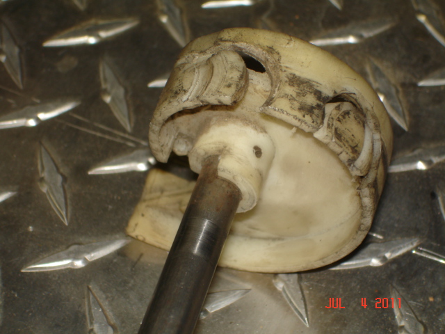

iaokie wrote:Ok I'll keep looking for a replacement and maybe I can find one by the time I get everything checked,cleaned and painted
What would the good price be on this cam if I can find one ?
Whatever the current owner needs to cause him to part with it! They really are very scarce.
The missing chunk is about at the saw-joint speed position. An epoxy that will adhere to the cam might work. I am guessing the cam is nylon, and adhering might be a problem.

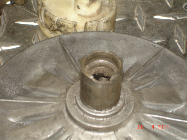

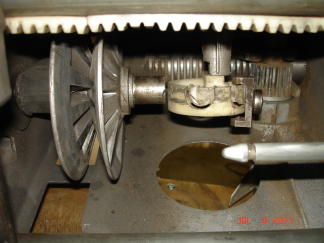

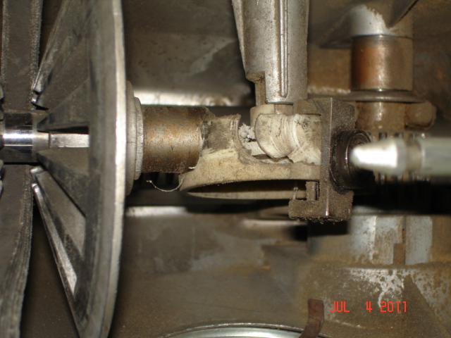

After more disassembling It's not looking good
Apparently the cam I had was an extra heres what I found inside

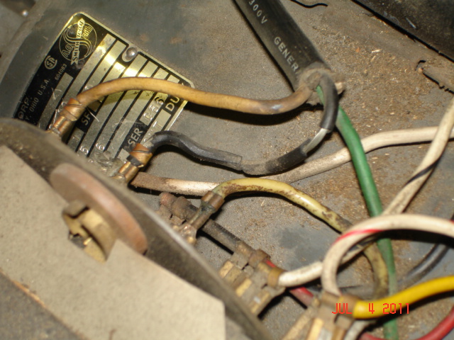

Power supply wires are rock hard and some are bare
The sheave looks ok but the end where the bearing fits into has a piece missing
Looks like the fun has just begun
