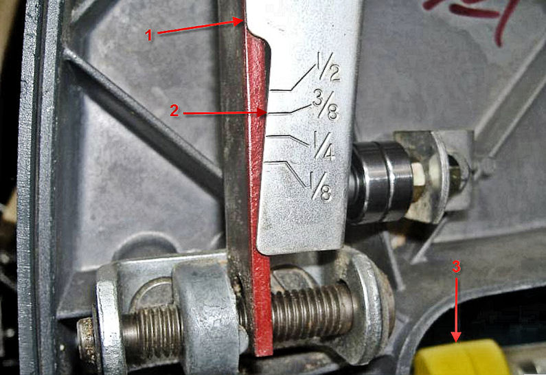

When you refer to "the edge above the notch " are you talking about point #1 in this photo or point #2. I have been using point #2 and would read it as set for a 3/8" blade. BTW, what is the yellow item at point#3?

I think the edge above the notch is #1.
There is no blade on, and from what I have gathered the reading is on the left of the red strip, as in it is reading "nothing".
#3 is a florescent tube lamp, not part of the bandsaw but I've been using it while working on the saw. I have the table off for now, want to be able to get the bearings adjusted before I put it back on.

prmindartmouth wrote:Ed
- Eds bandsaw.jpg (92.73 KiB) Viewed 13601 times
Yep Ed your good to go with it being detensioned. When I set the tension on mine, I have the red bar just disappearing behind the measurement of the blade width. Ya need to turn yours in the pic a turn or so to set it at 1/8.
OK, Ed, in tune with you now! Left edge disappears behind scale even with the band width just like manual says.......

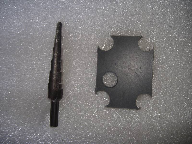

I wanted to add a bit more about the window I cut in the cover. I opted to do my own to fit a strip of 9600 lexan I had. It is smaller then the official window but I'm happy with the smaller size and can see the settings quite clearly.
I used some "figuring" to locate where I thought the window should go then masked the opening. Just in case I did a view port by drilling one hole to makes sure I was where I though I was. I was, so I then drilled the four corner holes followed by connect the dots to cut out the hole.
I used a step drill for the drilling of this as well as the hole for the adjustment tool, it worked great.
The picture shows the cut out piece just for reference:
[ATTACH]13787[/ATTACH]
