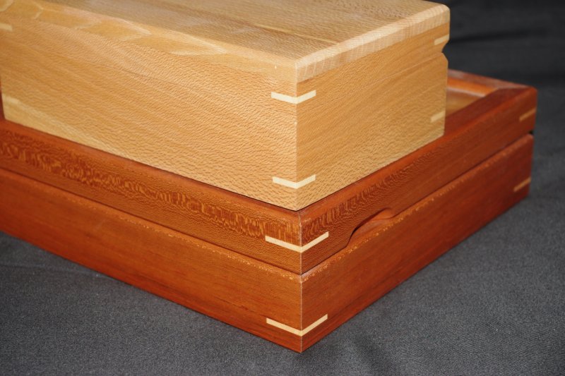

I need to update/correct some information I posted earlier about the saw blades I have for cutting square slots for feathers/splines in corners of boxes using my jig. The Freud blade was a TK406, 60 tooth, flat-top grind, but the current version shown on the Freud web site lists the TK406 as having an alternate top bevel grind. The other blade turns out to be a Vermont-American "Lightning" blade with 18 teeth and for framing, not a Laser blade as I stated earlier. This blade doesn't seem to be available any longer, although I did find one listed on Ebay and selling for $28, a price that is probably three or four times what it sold for when I purchased it.
Both of these blades were purchased back in the 90s, so that may explain why they're no longer available. Vermont American was since bought out by Bosch.
Here are a couple of boxes (one sycamore, the other cherry) with splined/feathered corners --

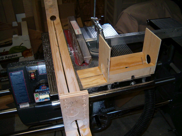

Finally got new camera batteries. Now for pictures of my simple spline jig(s). Not being a fan of making or using jigs, I try to keep them as simple as possible so as to not becoming time consuming by themselves. Just so long as the jig works as intended. I can keep my jigs for future use or throw them out. Nothing is lost either way.
Spline jig made by ripping a 2X4 at a 45 degree angle then glued to a base works for all splines. Don't even need a bar to fit into the miter slot,- just an extension on the miter gauge.
In this photo the small jig has been used to make splines and lately converted for ripping plastic pipe. It will be saved for more spline making.

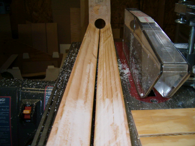

[ATTACH]13873[/ATTACH]
This photo shows the longer ripping jig for sawing a slot through PVC pipes. It will be disposed of when through with the project.
