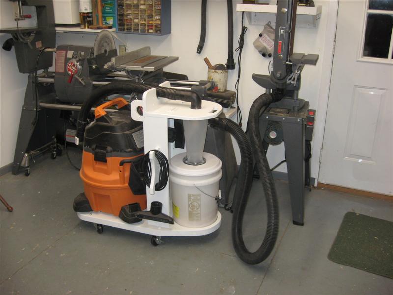

cart for dust
Post by oldc6 »
[ATTACH]15721[/ATTACH]picture of dust deputy and cart.......
IMG_1740 (Medium).JPG (60.57 KiB) Viewed 5362 times
