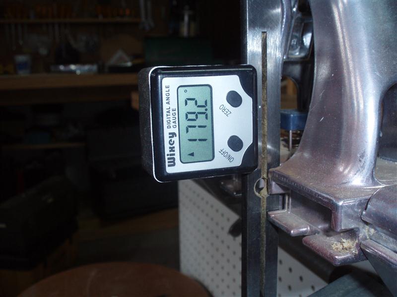

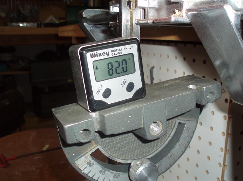

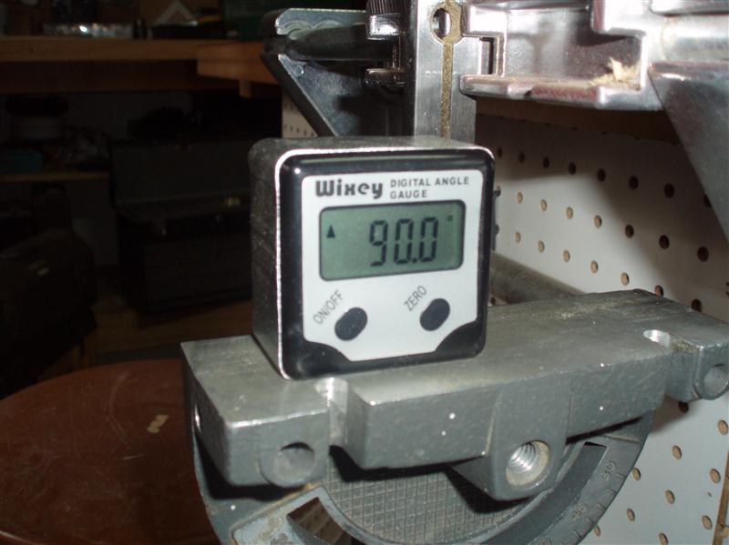

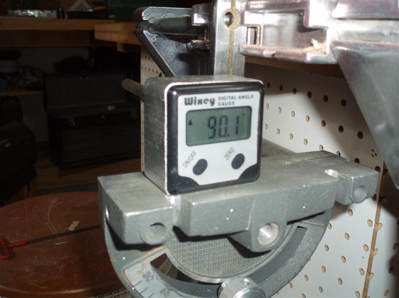

If the decision is to use a Shopsmith miter gauge, I would very strongly recommend something like the Wixey.
Miter Gauge Setup 002 (Custom) (2).JPG (55.81 KiB) Viewed 823 times
Miter Gauge Setup 003 (Custom).JPG (58.28 KiB) Viewed 822 times
Miter Gauge Setup 004 (Custom).JPG (66.56 KiB) Viewed 813 times
Miter Gauge Setup 005 (Custom).JPG (60.42 KiB) Viewed 810 times
Miter Gauge Setup 006 (Custom).JPG (56.95 KiB) Viewed 811 times
Although a very small error, realize the slot(and tapered screw) may not be parallel to the rest of the miter bar as it sits in the table slot. Any 'error' will change with the positioning of the screw into the tapered threads of the miter bar.
Yeah it be picking nits!;) But true nevertheless. Lay a straight edge against the side of the bar to 'see' the variation.
I trust the 'Miter set' more so than the wixey, and it is much quicker! It references a short run of the bar.
