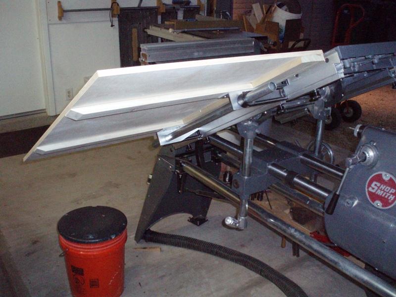

"The infeed/outfeed tables are great but impractical with Shopsmith since the table height changes with depth of cut."
Not quite so impractical if the infeed/outfeed table moves up and down with the main table.
[ATTACH]14788[/ATTACH]
Desktop 025 (Custom).jpg (70.63 KiB) Viewed 3201 times

Posts: 5834
Post by Ed in Tampa »
dusty wrote:Quoted from this thread.
I see this version of you outfeed table doesn't have that center support coming up from the bottom of the main table support tube. Is it just not mounted or is this a new change?
Ed in Tampa
Stay out of trouble!
Ed in Tampa wrote:Dusty
This is an image of the table from before the center support was added but the center support is used with one version of the table while it can be left off like the version shown here.
They work equally well but the version shown here takes a little longer to set up and tear down.
I install the outfeed table only when I am going to be using it because when installed it prevents me from walking around the Mark V. My work bench sets parallel to the outfeed side of the Mark V just out of view in this photo.
