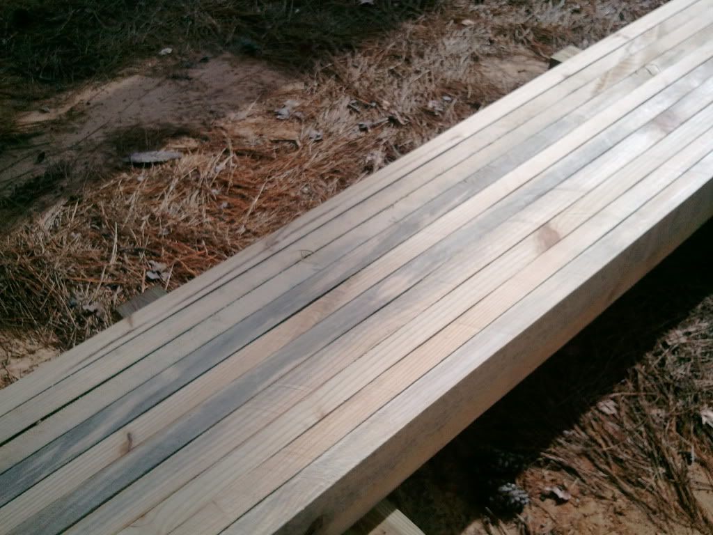

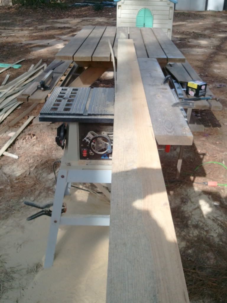

Since this is all rough cut lumber, every floor joist had to go through the table saw twice to get two (mostly) straight sides and get them all to a consistent width. I borrowed the little table saw from my father-in-law. The old picnic table made a good outfeed table.

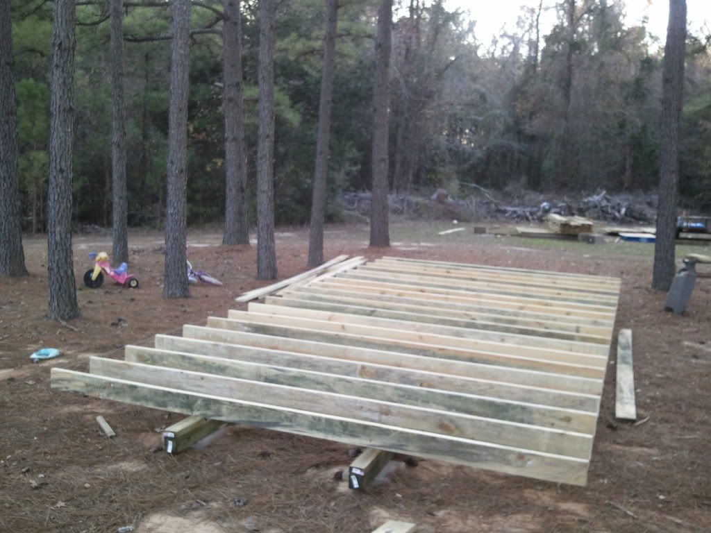

All ready to start laying out the floor joists.

I put down the first and last joist, measured front to back and diagonally to get them squared. Then I ran a string line from front to back on each side to guide the lateral placement of each joist. I cut a length of 2x4 to guide the spacing between each joist placing them 16" apart on centers.
I put on the side pieces, then had just enough daylight left to clean up.
Happy with the progress, but wish I could have made it a little further. I plan on putting 2x4s every 16" between the floor joists making a torsion box. I had hoped to get that done today too, but just didn't make it. It will be well over a week before I can do any more work.
