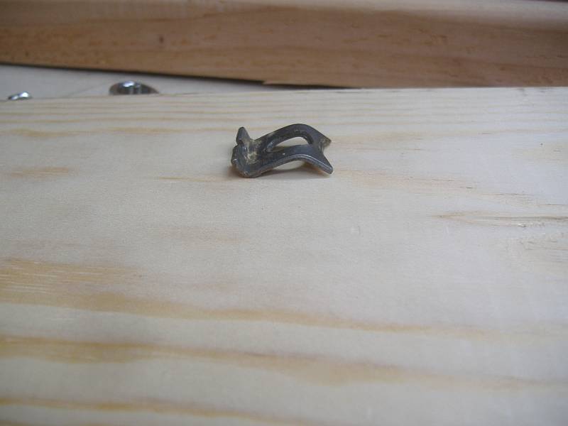

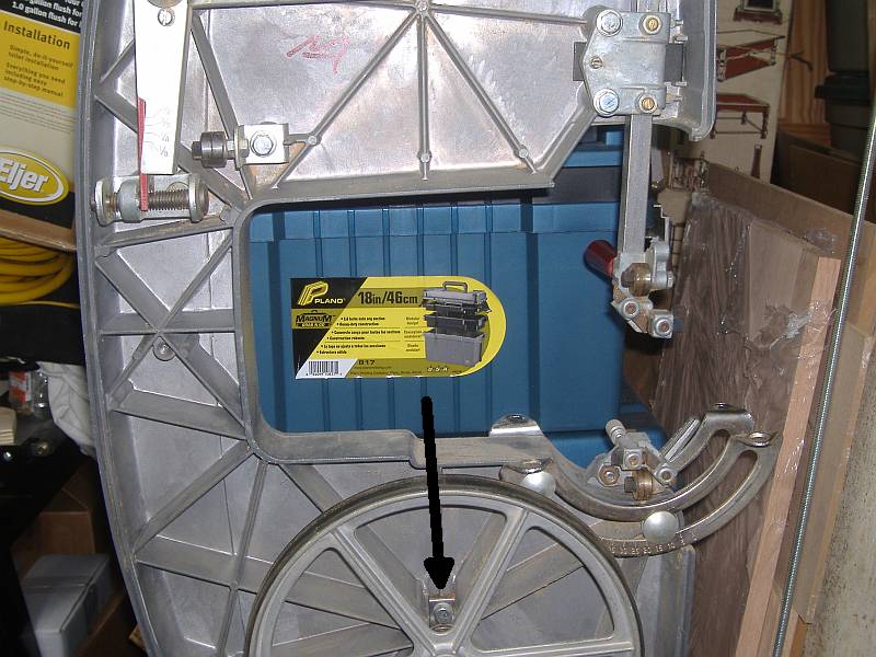

For anyone who might be lost at this point a couple of pictures in reference to the last few posts. As of now we do not know if this has anything to do with the problem but it is something you might want to check on your bandsaw.
[ATTACH]15311[/ATTACH]
Mine was really bent as shown. Sorry no photo of the "fixed" part but if the lower wheel can be moved in and out this is a potential cause.
[ATTACH]15312[/ATTACH]

reible wrote:For anyone who might be lost at this point a couple of pictures in reference to the last few posts. As of now we do not know if this has anything to do with the problem but it is something you might want to check on your bandsaw.

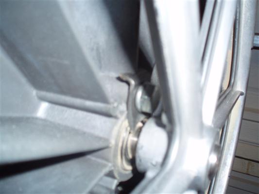

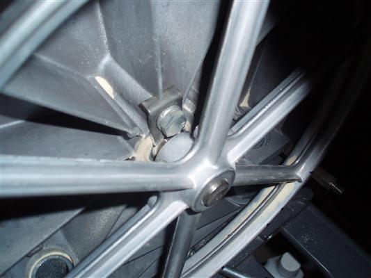

The way that piece is bent and the degree to which it is bent makes me think that it was done intentionally. The bolt that holds it in place would tend to flatten the bend if screwed down tight.
[ATTACH]15313[/ATTACH]
[ATTACH]15314[/ATTACH]
There is a slight bend in that part but it should be gradual.
On yours it almost looks like someone tried to drive the lower axle out from the back side without removing the retainer.
- Bandsaw Lower Wheel Retention 001 (Custom).JPG (35.28 KiB) Viewed 2253 times
- Bandsaw Lower Wheel Retention 007 (Custom).JPG (27.51 KiB) Viewed 2254 times
Perhaps the PO tightened it with the bearing jammed and instead of pulling the bearing into the bore, the bracket bent. That would be my 'guess'.dusty wrote:The way that piece is bent and the degree to which it is bent makes me think that it was done intentionally. The bolt that holds it in place would tend to flatten the bend if screwed down tight.
