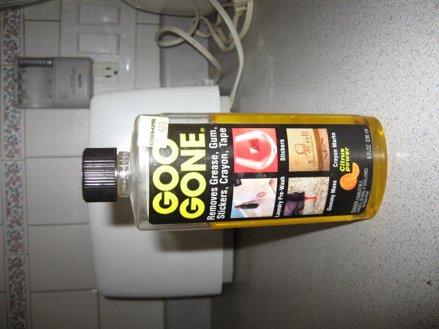

Well, the headstock I bought on Sat was a 1991 C type. Part of the large decal was coming up at the corners, so I ripped it off. The residue remaining was very sticky. Reminded me of the stuff I peel off the back of a new credit card attached to a piece of paper.
So I got some stuff my wife bought a long time ago: Goo Gone. It smells like oranges & it removed all the residue with some wiping with the Goo Gone on a rag. 10 minutes later- it was all gone. For some reason I must be getting closer to my "feminine" side, I read the directions which said after using Goo Gone, clean the surface with soap & water. I hope by actually admitting I read directions, I do not kicked off the forum...<smile> But I'm glad I did clean it off as the Goo Gone left a residue of its own. The new decal went on perfectly.

I just did the Power Pro upgrade. At the end, Jim says to leave the old labels on because nothing will remove the adhesive residue. Well I found something that easily removed it & smelled like oranges. Goo Gone. Pic attached. It smells like oranges and must then me cleaned off with soap & water to remove the chemical residue.
Tony
