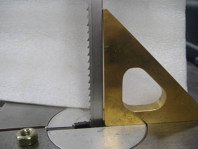

charlese wrote:When I found this condition on my saw, I fixed it by adjustment of the "blade column adjusting post". You know - that "Upper blade Giude".
By the Way - It's a good thing to have the bandsaw table line up with the main table for out feeds of re-saws.
Thought the table connection through the trunnions is a bit too shaky to trust on shimming the table.
Please explain what adjustments to the post will eliminate the blade to table angle.
Methinks only flexing the blade (the long way - teeth to back) would correct the angle. The upper guide is supposed to clear the backup bearing.
You got me cornfused here!:)

Oh boy that is off a lot. Sorry just talking to myself after being out looking at the bandsaw table issue on my saw.
Want to see?
Sure, have a peak.
[ATTACH]16038[/ATTACH]
Oh boy this is a lot.

Yep, Ed. Just like mine. You can imagine what a circle cut out of 5 1/2" thick wood would look like.
Finally found a combo of washer and Cool Whip lid that brought it dead on.
