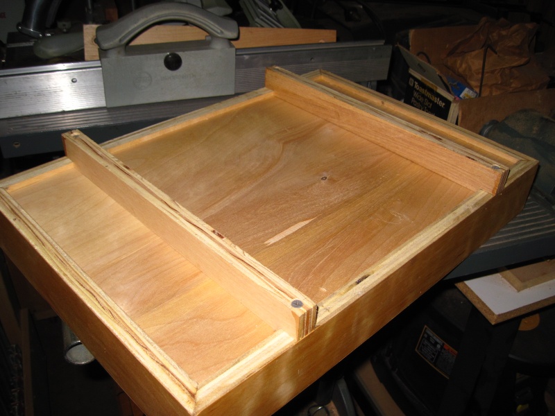

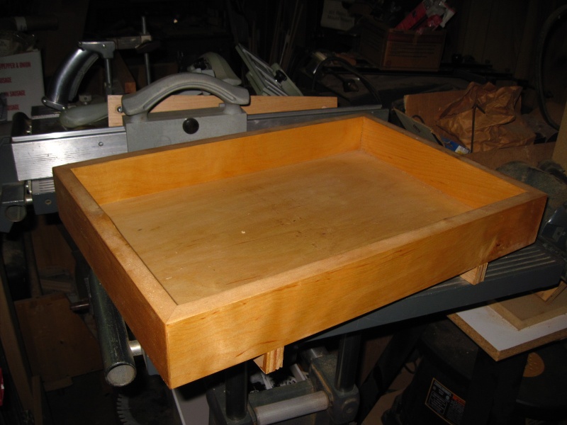

Would you happen to have a copy of your plans I could use to build one?pennview wrote:I use a simple tray with sides (like a shallow drawer) for holding the lathe tools while turning. There are two slats running across the tray on the underside, spaced to fit outside the way and bench tubes that keep the tray from sliding off of the Shopsmith while in use.
You can make it as wide as you like to hold your set of tools. It's similar to what Mike G mentioned, but designed to fit the Shopsmith. It doesn't have any dividers, but one could add them if desired.
BPR
I don't have plans for the tray, but here are a couple of photos that should help. The outside dimensions are 14" wide by 20" long by 2 3/4" high, but you can make it whatever size fits your lathe chisels. The two cross slats on the bottom of the tray are 11" apart so it will easily keep the tray on lower tubes as well as the way tubes. I used 3/4" birch plywood. The corners are mitered and the bottom is 1/4" plywood fit into a groove/dado about a 1/4" up from the bottom edge of the tray.
[ATTACH]18120[/ATTACH]
[ATTACH]18121[/ATTACH]
- ChiselTray-1.jpg (126.71 KiB) Viewed 4248 times
- ChiselTray-2.jpg (148.61 KiB) Viewed 4255 times

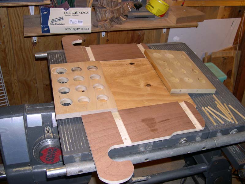

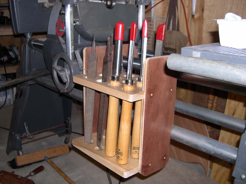

I believe this is what brick 1 was referring to........
[ATTACH]18333[/ATTACH]
[ATTACH]18334[/ATTACH]
- Shopsmith Lathe Tool Holder 1.jpg (82.02 KiB) Viewed 4036 times
- Shopsmith Lathe Tool Holder 2.jpg (73.49 KiB) Viewed 4040 times
