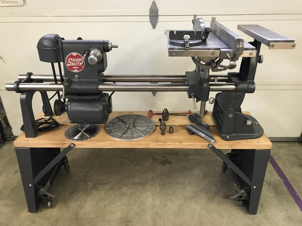

This one isn’t a steal. Unless, that is, you value your time doing restorations at more than maybe $5 per hour. But it is mighty purty — think restorations by Skip Campbell or maybe J.S. Burger.
https://dayton.craigslist.org/tld/d/day ... 72391.html
And don’t forget to check out the included accessories.
When’s the last time you saw a 10ER listed by a friggin’ pawn shop? No relationship to the seller, although I’m tempted myself. It’s only an hour away from me.
Any opinions as to whether this is a restoration or a mint-condition original? I’m leaning toward the latter, based on the condition of the literature and the accessory packaging, plus the minor paint scratches on the jigsaw.

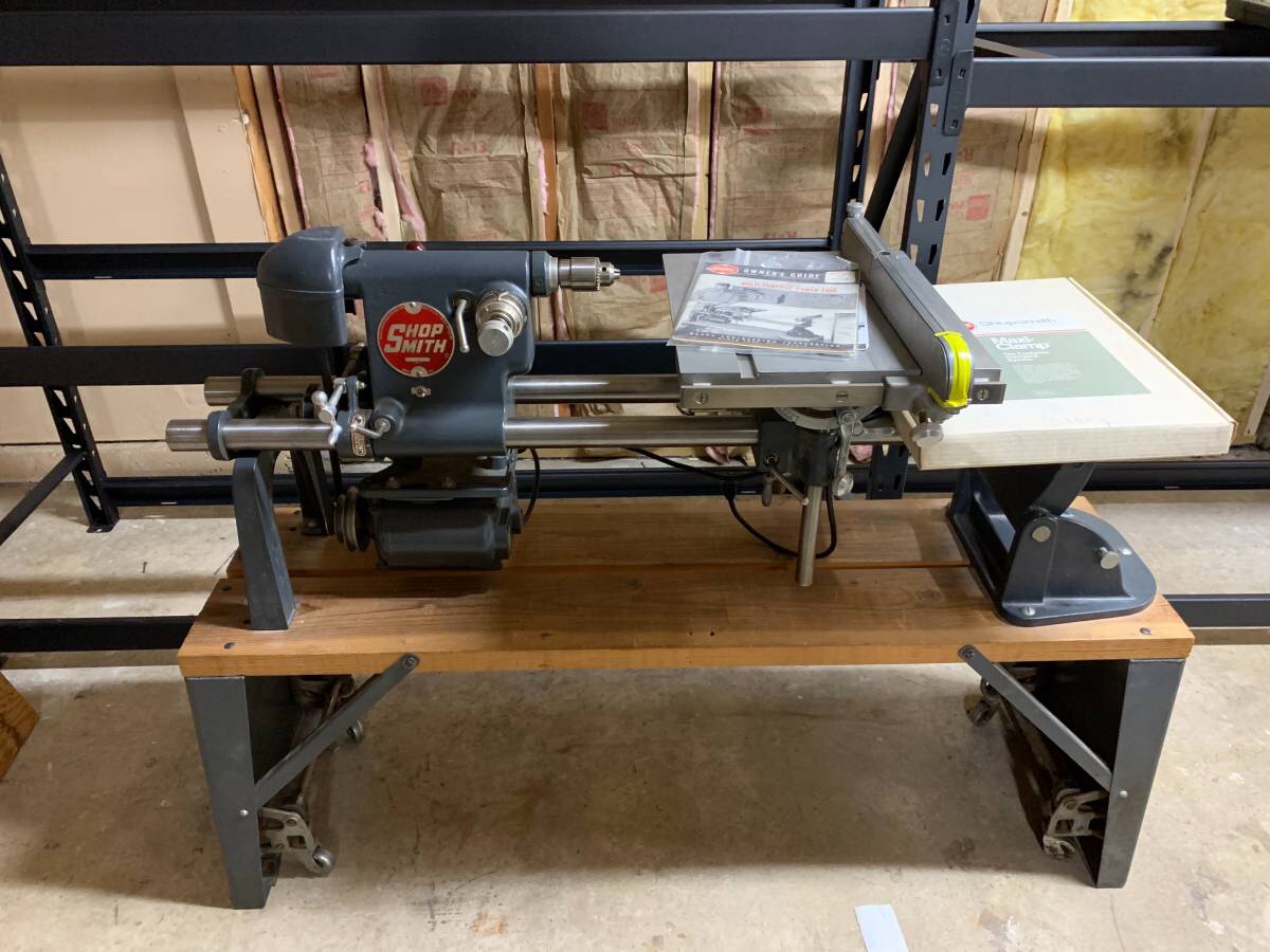

Although a nice looking restoration not all the parts are original to that particular Model 10ER. The Belt Cover is an earlier one mostly found on the 10E or early 10ER. This Model 10ER has the last Headstock version 7 and should have the later Belt Cover. The Blade Guard is the last version but is missing the splitter. If original makes the 10ER a later one made but I cannot read the serial number. For the Jig Saw I cannot see if it has the coupler to connect it to the Quill's spindle or if it has the spacer for the Mounting Bolt for use without the upper arm. It's table insert is in the box of parts. Other nice accessories included. The boxes of some of the accessories are in good looking shape too. I wonder what the yellow tape is for on the fence.
As for the price vs. value that would be up to the buyer to decide.

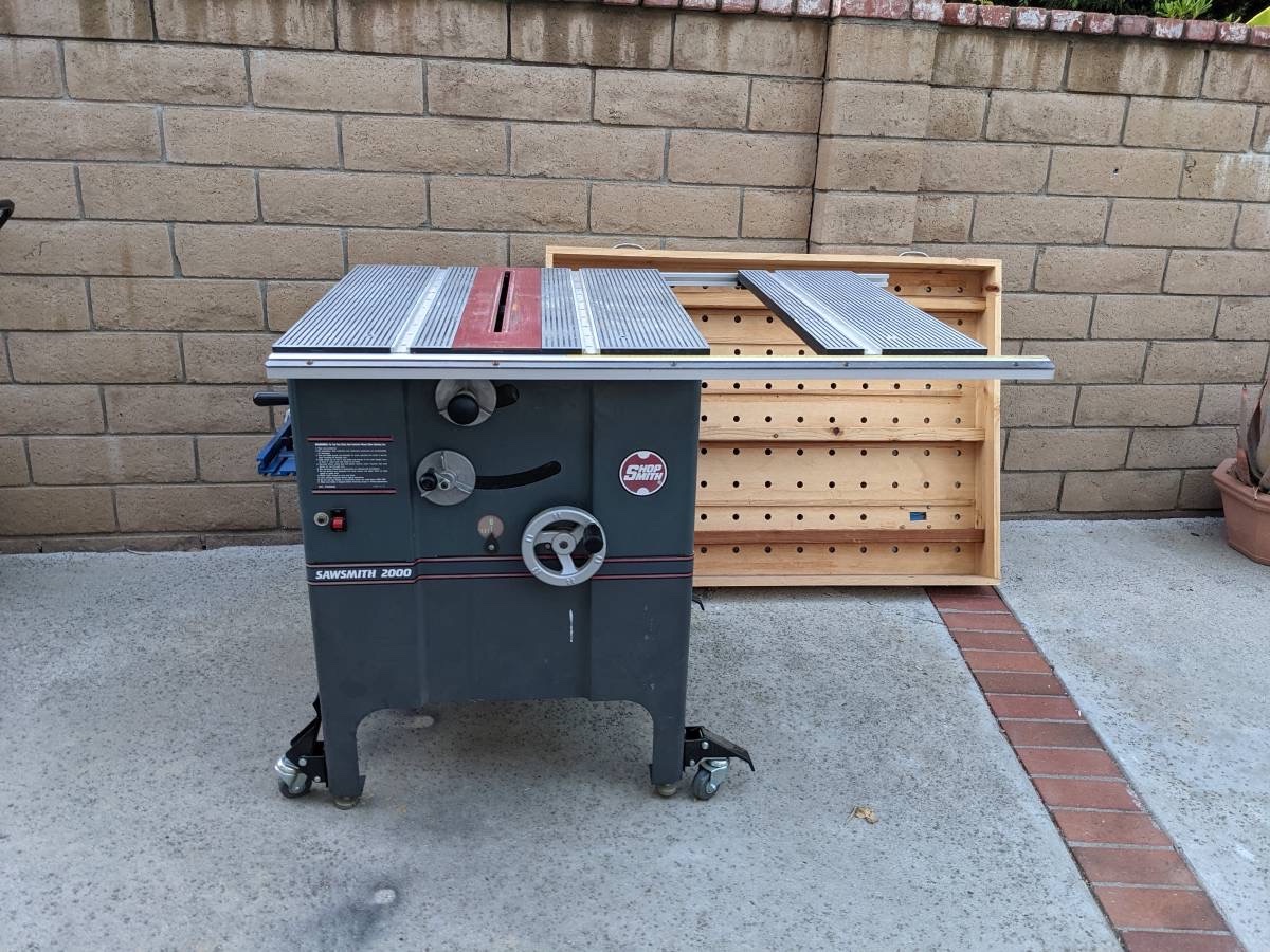

ShopSmith Mark 5 and a SawSmith 2000, Belt Sander, and Jointer for $800. It an hour north of San Diego.
