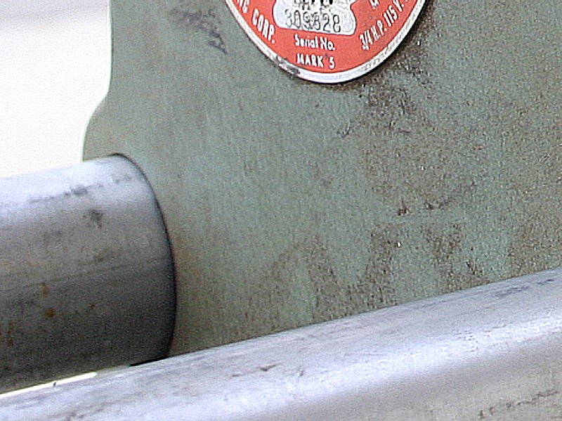

fjimp wrote:Each post I have red here made me wonder if the issue could possibly relate to a need to loosen and turn the way tube to be certain they are round? fjimp
I Do not understand how out of roundness could cause this.
Look at post #75 this thread. This clearance 'issue' existed originally. You did NOT do anything to create it! I see only 4 belt cover screws in all the pix. Do the bottom two screw into holes in the motor pan sheet metal or ???? It appears the top two thread into tapped holes in the headstock.

JPG40504 wrote:I Do not understand how out of roundness could cause this.
Look at post #75 this thread. This clearance 'issue' existed originally. You did NOT do anything to create it! I see only 4 belt cover screws in all the pix. It has a total of 6. One on top, 2 each side, one directly on bottom. Do the bottom two screw into holes in the motor pan sheet metal or ???? The bottom 3 screw into the sheet metal motor pan. It appears the top two thread into tapped holes in the headstock.
Hey, after your newly acquired hyperlinking knowledge evidenced in this post you made, I would have expected your reference to post #75 above would have looked more like this...."Look at post #75"!! Just think of all the poor folks searching back into the bowels of this thread, looking and looking and looking, chewing up bandwidth, being non-productive at work...need I go on? :D
Very interesting observation you made regarding post 75. To save folks from going back AND to provide more detail, here's bigger version of that picture
[ATTACH]4244[/ATTACH]
Although not significant, there MAY have been clearance, Clarence. I wouldn't bet your life on it but...
