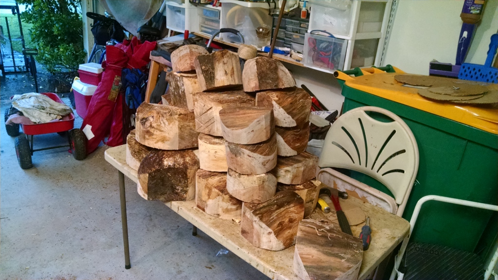

Getting started on my batch of blanks that have been drying for 2 years now. This will be my first attempt to turn bowls from dry wood. I first removed the bark, then turned them round on my bandsaw using a 1/2 inch blade, using my cutouts as a guide. The next step will be to begin turning the bowls on my 10ER lathe.

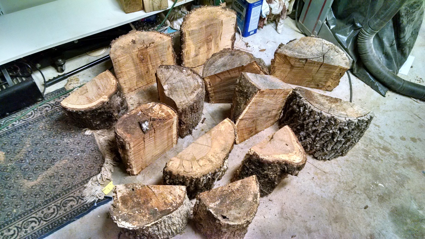

- Cut some logs in half, them split them into 6 inch halves to fit my band saw
- IMG_20151025_104739015_HDR.jpg (695.88 KiB) Viewed 19106 times
- Removed bark first
- IMG_20151025_104823388_HDR.jpg (687.18 KiB) Viewed 19106 times
- Cut round on band saw using 1/2" blade on my Power Pro 520.
- IMG_20151025_115711919.jpg (271.34 KiB) Viewed 19106 times
- Ready to start turning later in the week

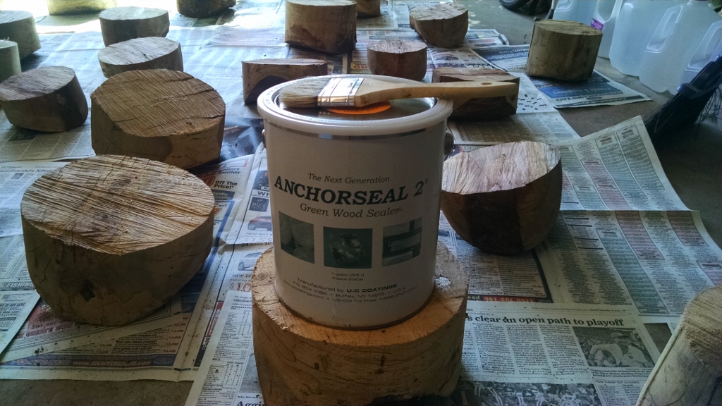

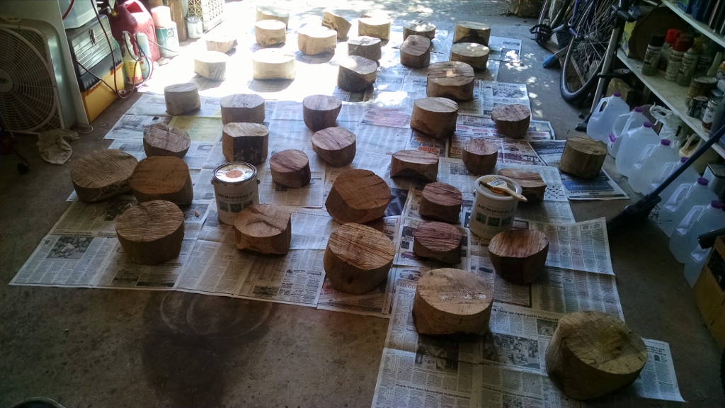

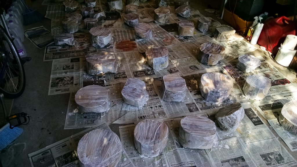

Finished preparing 42 blanks to be turned into bowls. I applied sealer on the blanks to prevent them from cracking since it will be a few weeks before I can get started on the turning process itself. This batch of wood has been drying for about two years now.

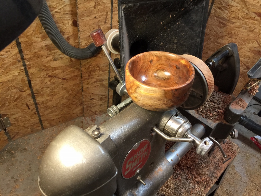

Here is my first bowl that I have managed to turn since recovering from my Achilles Tendon surgery last February. I used dried wood stock instead of green wet wood. I must say I much prefer using green wood because dry wood blanks will blow up while turning if there is even the slightest crack in the wood. You could get away with this with wet green wood because no cracks have formed yet. I blew out 3 bowls before finding a blank without any drying cracks.
