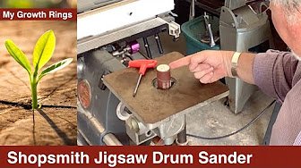

Last vid from the Garage: Shopsmith Jigsaw as a Drum Sander
Posted: Mon Jun 28, 2021 6:57 am
by Chad
Watch it here: https://youtu.be/IMy0YpJl61o
One final "trick" that we can do with the Shopsmith Jigsaw (or a clone like this one) is to use it as a reciprocating sander. This is also the last video I'll be shooting in the garage shop, so be sure to catch the sneak-peek of our new temporary digs in my sister's basement at the end of this video.
