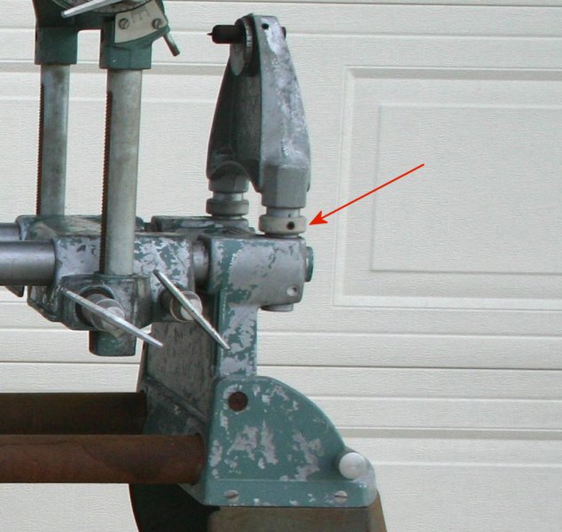

I attached this picture to see if anyone can tell me where these steel rings "officially" live on the unit and what are they for? Since all the vertical heights have locking elements already, are they intended to go on whatever your working with as a redundant system if the locking elements fail?
[ATTACH]4282[/ATTACH]
- Img_4843mod3.jpg (65.71 KiB) Viewed 3181 times

Used for any mounted accessory that need to be set at the correct height for ease of setup (jointer, bandsaw, extension fence, etc).mickyd wrote:I attached this picture to see if anyone can tell me where these steel rings "officially" live on the unit and what are they for? Since all the vertical heights have locking elements already, are they intended to go on whatever your working with as a redundant system if the locking elements fail?

The intended purpose of the collars(usually used on the tailstock as shown) is to provide a non-adjustable highly repeatable stop. In the case of the tailstock, once you have aligned the tailstock center with the quill(center to center), the collars may be attached so as to eliminate the alignment procedure each time the tailstock is put back on the SS. They MAY be used on other tubes, but this is the primary intention.mickyd wrote:I attached this picture to see if anyone can tell me where these steel rings "officially" live on the unit and what are they for? Since all the vertical heights have locking elements already, are they intended to go on whatever your working with as a redundant system if the locking elements fail?

Those are used to keep the alignment of the lathe points.
Like JPG and Bob said - your photo shows the rings in their approximately correct position. They are a VITAL part of the tailstock. They even have a fancy name of "Tube Collar Assembly"
http://www.shopsmith.com/ownersite/part ... xpview.htm
When these collars are correctly placed and the eccentric properly set. the tailstock can be taken off and replaced many times and it will remain centered with the quill. Also, when tightened down, I have found absolutely NO wiggle or play in my tailstock over many - many uses.
