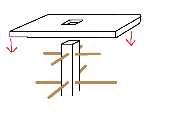

One idea I had after initially posting my question was to use dowels as arms coming off the post to support each shelf as this crude drawing shows.
[ATTACH]24089[/ATTACH]
Don't glue the dowels in, just insert them into holes drilled in the post. Put in the lower level dowels, slide the bottom shelf over the post down to rest on the dowels, put in the middle level dowels and slide the middle shelf on, put in the top level dowels, slide on the top shelf. Reverse the process to break down for more compact transporting.
Thoughts?
Thoughts?

Instead of using a solid 4x4 post and cutouts in the shelves, it might be easier to assemble it more like a table lamp.
Cut the 4x4's so that they act as spacers between the shelves. Bore through-holes both in the spacers and the shelves. A dowel could be used as the "spine" if you want to glue it together.
Personally, I'd probably use a length of all-thread and bolt it together, so that it can be disassembled. A mounting block with blind nut, fastened to the underside of the top shelf, would keep the fasteners invisible.

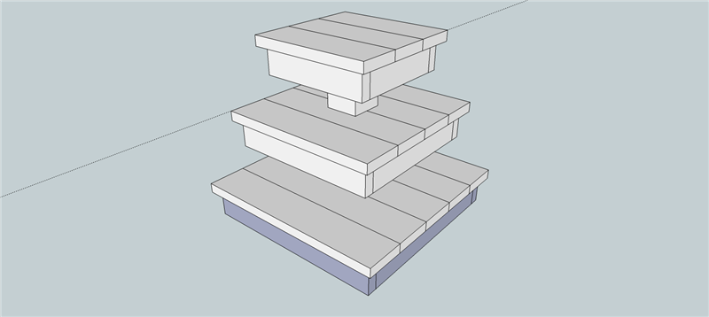

The image makes it look as though the center post is a 4x4 but looking more closely at Pinterest images online, I do not believe it is. I believe it is more like 2 1/2 x 2 1/2.
This is based on an assumption that the shelfs are 3/4" thick. It is a guessing game from there.
My concept done in Sketchup.
[ATTACH]24090[/ATTACH]
If you have Sketchup on your computer and you want this file just let me know and give me an email address that I can send it too.
- Cup Cake Shelf.png (51.04 KiB) Viewed 12164 times
