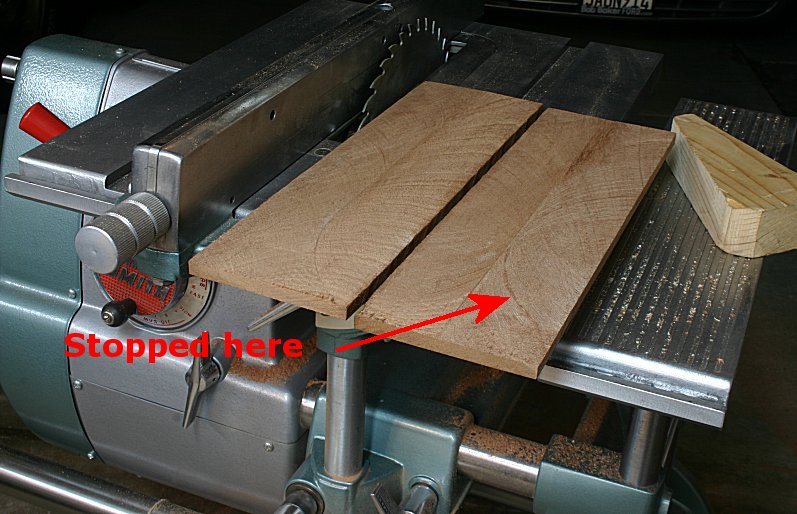

Worked on the lantern bases last night. The 3 bases will each be 3/8”Tx4”Wx4”L. Started with a piece of 1”Tx4”x13” and used the ‘controversial’ free hand rip method shown in post 50 to get the 3/8”Tx4”x13” slabs. A difference this time here was working with a longer piece of stock. Making the cut felt very smooth and controlled. I made the first pass through the entire length, flipped the board, and ripped through stopping a couple inches shy to leave a web between the two halves that I finished with a handsaw. Still many of you that wouldn’t make this cut?? I don’t want to build a false sense of security and really want your input. Like I said, it seemed OK but so is running across the road with your eyes closed…..sometimes.
[ATTACH]8107[/ATTACH]
You’ll notice lots of saw marks on the slabs. Still don’t know for sure if it’s me or as dusty had suggested, possibly the blade. Any easy way to verify the blade?

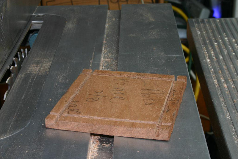

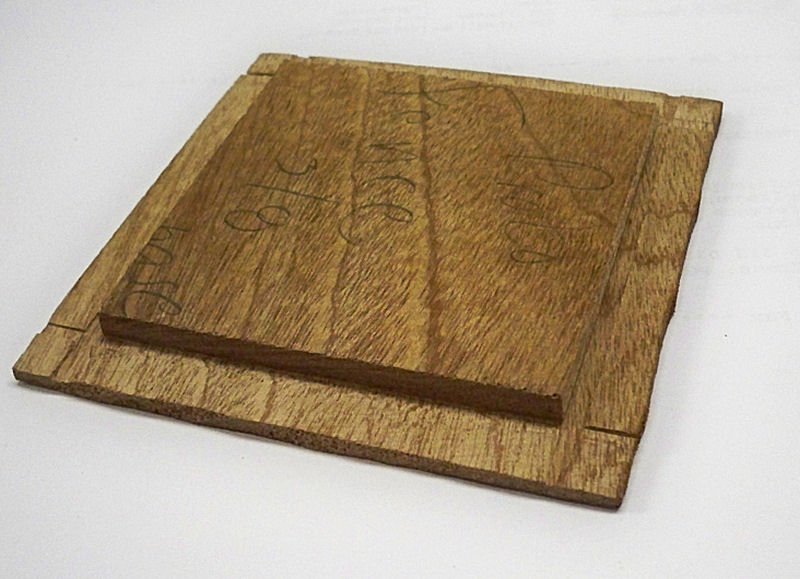

Once I got the squares cut, the next step was to add the rabbet that holds the base in the groove on the bottom rail and also supports the glass. My first rabbet.....horray!! and it came out…..HORRIBLE. I think I did it back-asswards. I first cut it to depth.
[ATTACH]8109[/ATTACH]
After cutting to precisely the correct depth, I measured the width and realized that I set up to the wrong side of the blade. It was precisely inaccurate by a blade width too wide. :o (Now I know for sure you 'seasoned' guys have never done that before) :D
I then stood the part on end and ripped to depth, or at least attempted to. You can see by the grooves on the rabbit surface that I botched it up…..salvagable with some kind of creative rework, but botched. I was kind of surprised since I felt that I really measured pretty accurately with a steel scale. Maybe I had a pre-senior moment??
[ATTACH]8110[/ATTACH]
So, when I said I did it back-asswards, I probably should have first stood the part up on end and ripped to the depth then cut to width having the saw blade just break through the surface. Is that the correct way to do it?

Hmmmm....just read up on table saw rabbeting at the ShopSmith academy site in the joinery sectionand procedurally, I was doing it right. Cut surface first, edge second. My surface cut was just too deep.
Looks like it's a practice issue!!

The rabbet would have been a good place to use the router with a straight bit, no? Or at least a dado blade against (and partially in) a sacrificial fence.
I learned cutting rabbets on a table saw from The Wood Whisperer. One thing I learned was you don't want the cuts to come together. Cut the surface depth a bit shallow, then cut into the side just far enough to cut the scrap loose. You'll have a little ledge in the corner - clean that up with a hand chisel for a perfect corner.
If you don't already, get a set of hand chisels then sharpen them to scary sharp. They can clean that rabbet right up. I'm a newb too, so someone else might have a better idea, but that's what I would do. The set I have was cheap. Not Harbor Freight cheap, but Lowes cheap. They seem to work just fine for me. Getting them sharp is the key.
