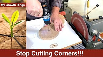

How to Make Fast, Perfect Wooden Circles
Posted: Mon Aug 02, 2021 7:01 am
by Chad
Watch it here: https://youtu.be/sP4bZaW6vqo
There are so many interesting projects that need precise circles, such as tabletops, toy wheels, decorative items, and functional items such as these hurricane lantern candle bases. This simple, fast and safe process is as easy as 1, 2, 3, 4, repeat.
1️⃣ Mark the center location and draw a circle with a compass. Don't skip this step by tracing a circle from another round object, because you'll need
that center location in step three.
2️⃣ Cut the circle slightly oversized on the bandsaw.
3️⃣ Drill your center location with a hole that will accommodate your pivot point. I used a 5mm dowl because that's what I had on hand, but you can
pivot on any size dowel or pin as long as the hole doesn't cause problems with your project. If your circles are wheels for a toy, use a hole that will
later match your axel size, for example.
4️⃣ Use your Mark V's sanding disc to sand the wooden discs to the exact size, pivoting on a pivot installed on a piece of scrap clamped to the main
table. I typically make the first one very carefully and set the depth stop for all successive discs.
🔴 Subscribe to the channel here: https://tinyurl.com/xz44rxmu
