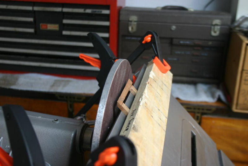

Tad and a half more progress last night on the prototype lantern. Got the edge miters sanded and made it to dry assembly of the sides to the base. I used a 120 grit sanding disk which was probably a little too aggressive but that was all I had. I need to get some higher grits.
My fear of the 45° miter edges not being tight as a drum up the entire height of the part was unwarranted. With real careful staging while doing the disk sanding, the edges came out perfect…….except…..I removed about 1/16” too much material. The uprights (stiles) are about 1/8” narrow than plan. This error came from both the initial miter routing removing about 1/16” too much and then the sanding removing about 1/16”. Initially, I didn’t have my quill stop set. Since the first piece was off, I had to do all of them the same. This will require modifying the glass width just a little for this lantern. No biggie.
Here is the initial staging of the side to get the mitered edge lined up to the sanding disk. I used two 3/8” wide woodruff keys between the part and the table edge for alignment prior to clamping.

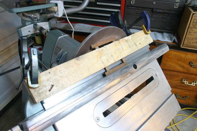

Once the part was aligned, I clamp it to the table and removed the keys. This is probably the point where I should have set my quill lock.

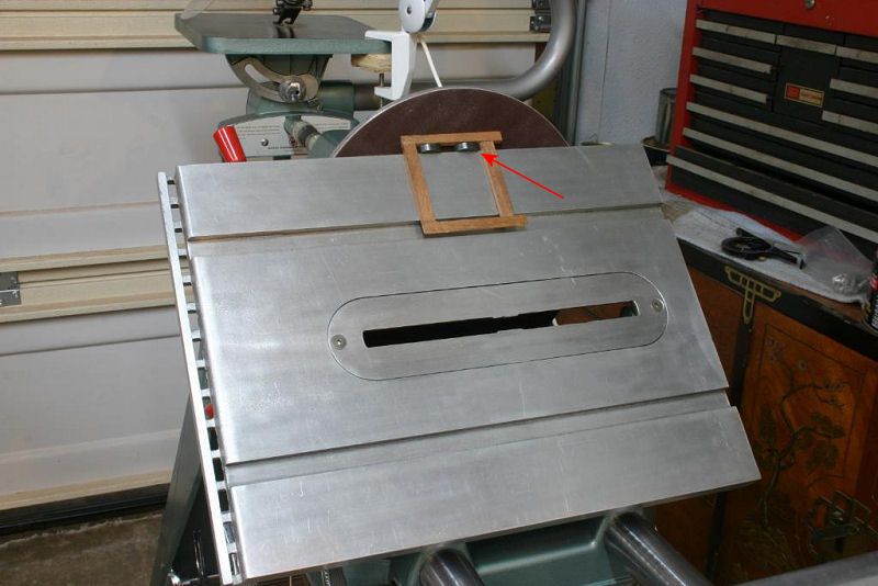

After seeing how quickly the stock got removed by the sanding disk, I am thinking that on the next lantern(s), I won't even bother cutting the 45° miter with the table router. Instead, I should just sand it. One less op to screw up on. The 120 grit paper quickly chewed through the mahagony. Once I did the one edge on all 4 pieces, I installed the rip fence and used that as the stop for doing the other side.

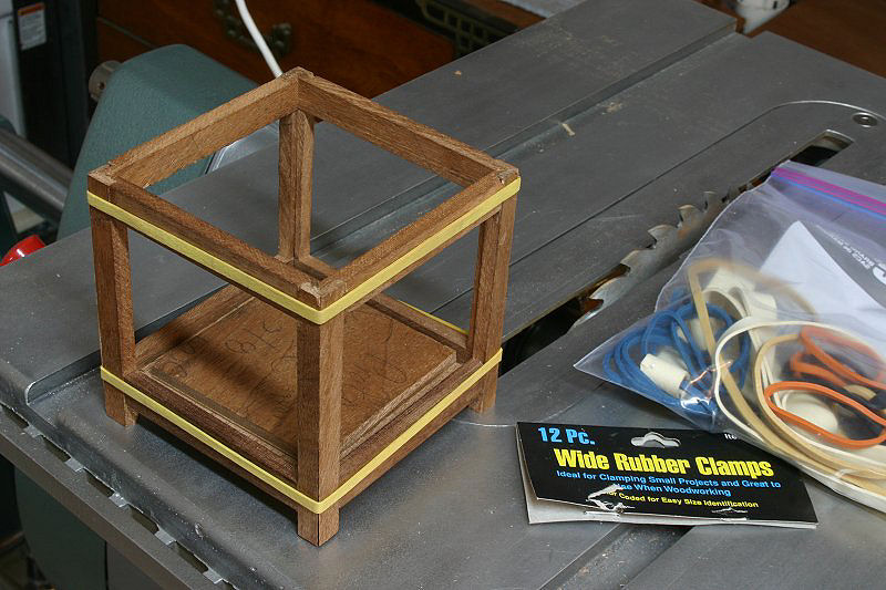

Finally step for the night was a dry assembly with rubber bands.
[ATTACH]8171[/ATTACH]
For the final glue up, I am going to use strap clamps as mark-b had suggested. After that, I just have to make the top, cut out the copper flower motifs, cut the glass, and glue her up. Then I start the other two.
Procedural or ANY other critiques welcome!!

I'll give the masking tape method a try on one of them. They showed that method in the directionsbut I was concerned that it wouldn't pull the joints closed. I'm sure it's a technique easily learned.shipwright wrote:Strap clamps are great, rubber bands work well for less, but for my money I have to say I'm a masking tape guy from WAY back. The world's most universal clamp. You can even edge glue veneer with it.

Stick the masking tape to one side and the stretch it as you take it to the other side and then stick it down. It does give good pressure but you have to use good masking tape. The cheap stuff doesn't stretch and squeeze.
I've used it for years. Once you've tried it you'll use it A LOT for clamping.
