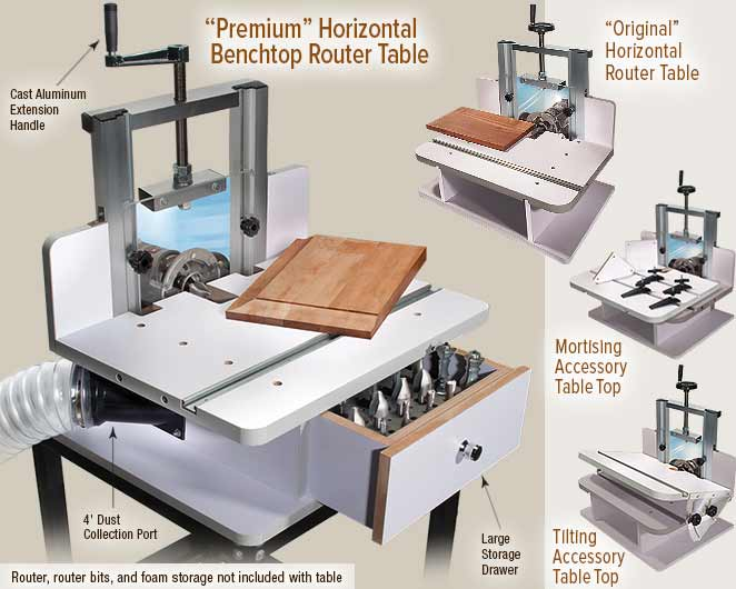

It looks like a good system for when it came out on the market in 1979. Though I have seen mixed reviews for them on this forum in the past due to people picking them up on the used market and finding issues with them. With no replacement parts, I don't think I would invest in one unless you just have to have Shopsmith's version of it. There are more modern versions of this concept, such as the one below from MLCS that I have seen and it is reasonably priced.
