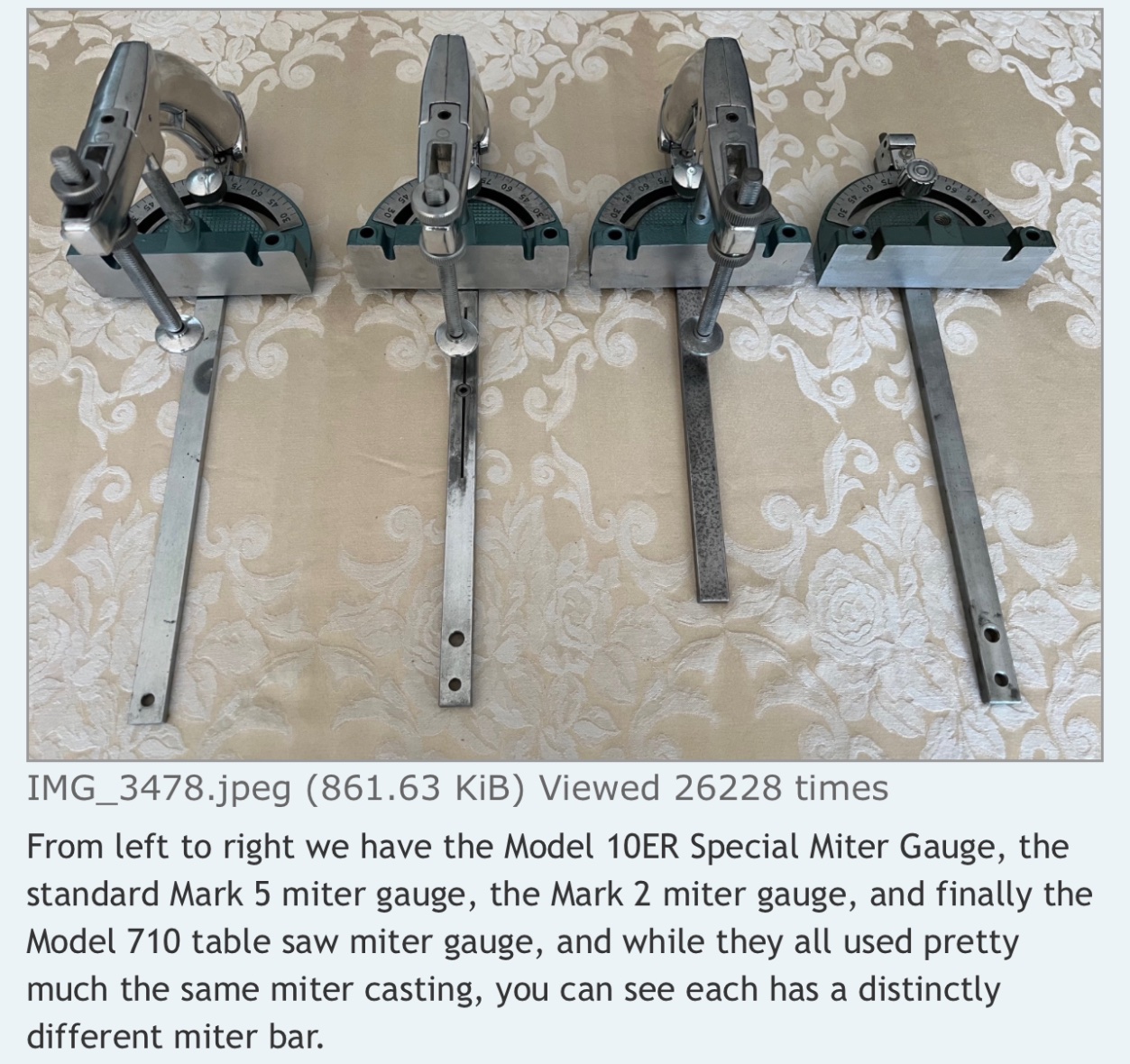

chapmanruss wrote: Fri Oct 11, 2024 1:01 pm I did notice that the Miter looks like the special Mark 5 style Miter with the Model 10 Bar. Is that true?
No, this miter is unique to the Magna standalone table saws (and their Powr-Kraft-branded equivalents). You may recall a post to the Share Your Magna Memorabilia thread back in February this year that showed some of the different green miters:

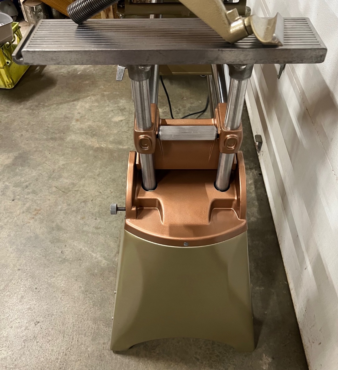

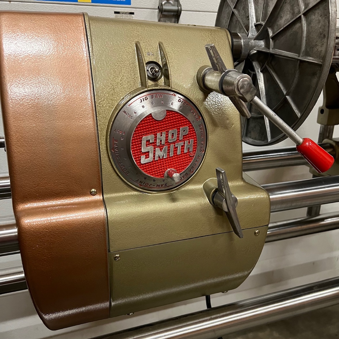

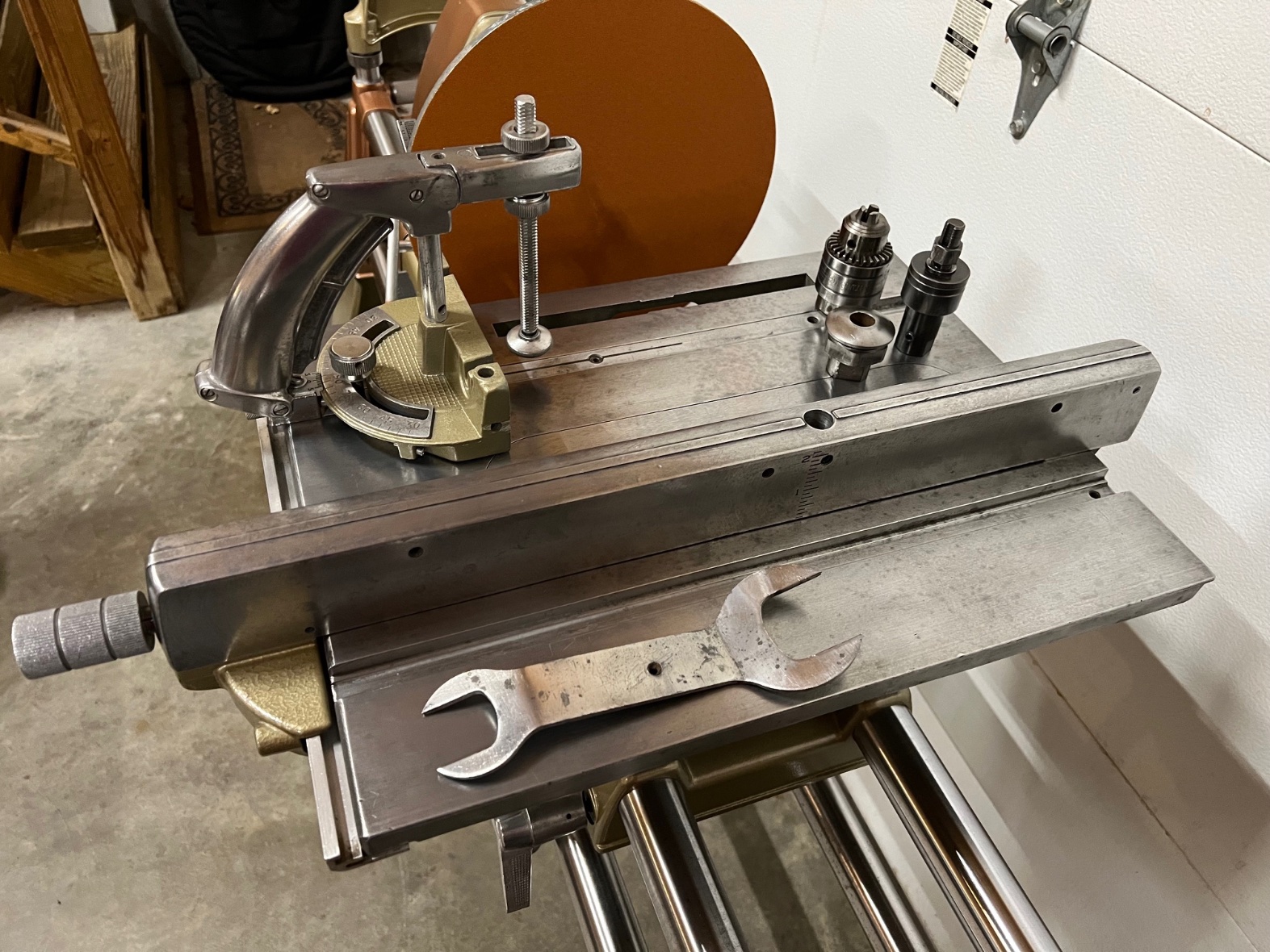

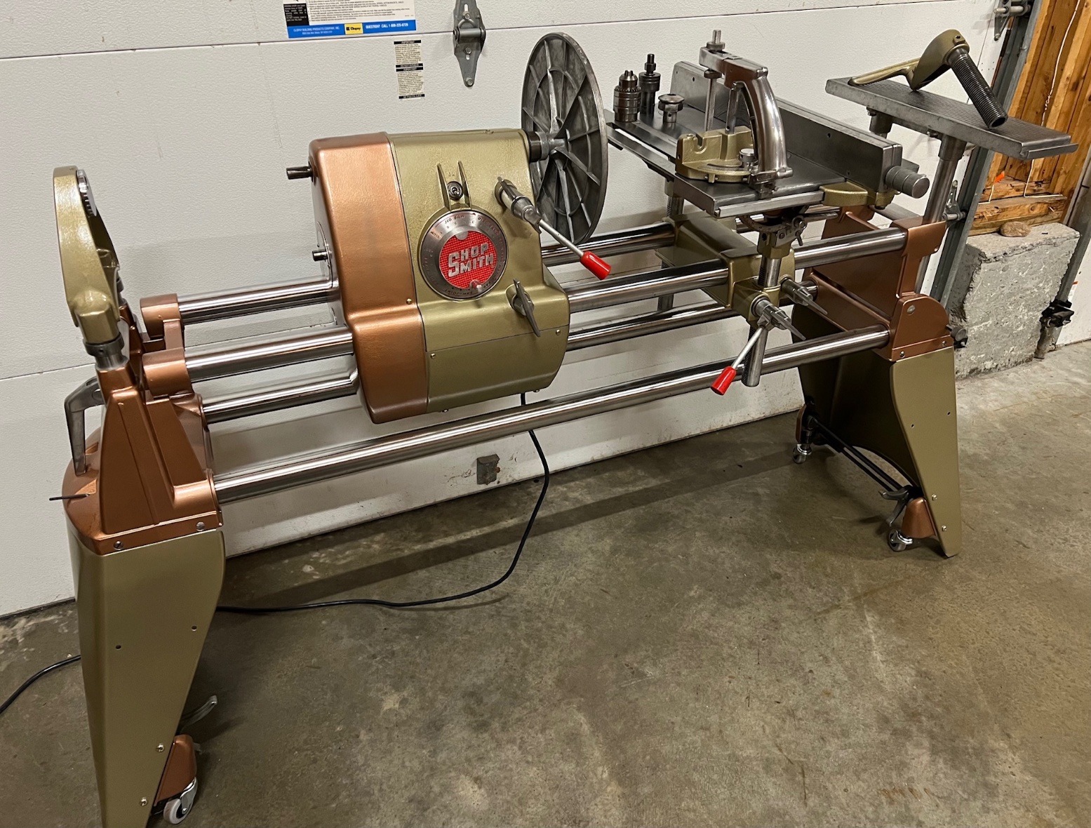

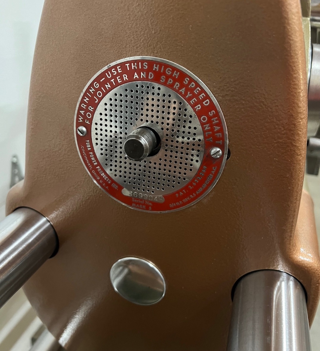

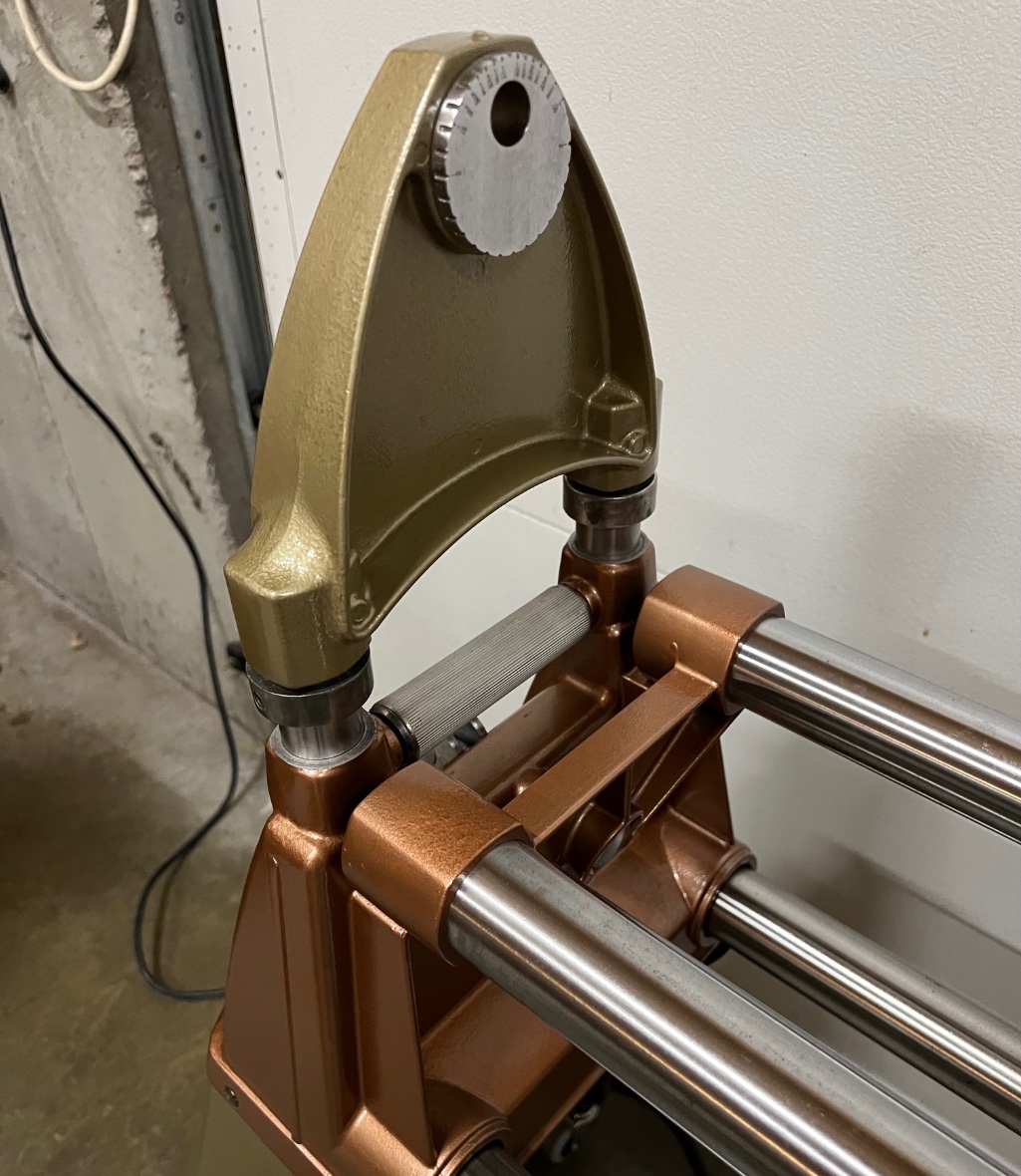

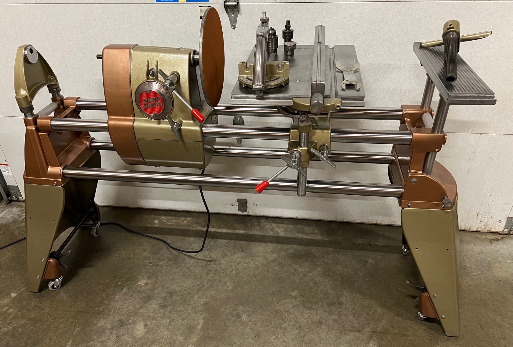

1961 Yuba Mark 5 Goldie - Serial Number 369904c
I’m on a roll here! Taking some stay-cation over the last week, and using that time to crank out some lingering projects. This is my first Goldie restoration - very pretty machines for sure, but I think some lower material quality (and quantity - much lighter casting and lighter gauge sheet metal) prevents these from polishing up as nicely as the Greenies…
This one is earmarked for my oldest son, and I’ll be pairing it with a Magna American Goldie bandsaw that is still in process, and maybe a jointer somewhere further down the road.
There was some chatter about this serial number sometime back when I acquired the machine, as it was an example of the “c”-suffix serial numbers that were a transitional design just prior to the introduction of the poly-v style drive - making this one of the last of the Gilmers…

GetterDone wrote: Tue Oct 15, 2024 10:59 pm I like the paint colors :cool:
I agree - love the Goldie color scheme… For this I used Rustoleum Hammered Gold and Copper. Matches the colors on the brochure from the day reasonably well.

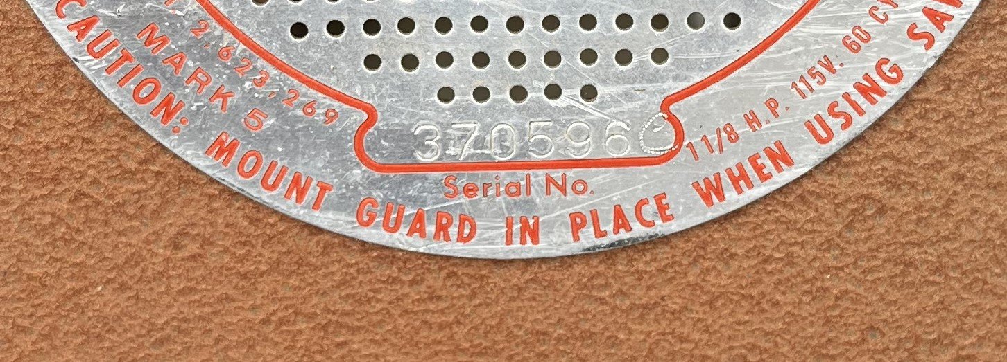

For others reading this and wondering about the Mark 5 with the "C" after the serial number, as John said, they were a transition unit still using the Gilmer Drive but with changes to the Drive Sleeve and Quill Assemblies. It was also during this time that the Mark 5 changed from the 3/4 HP Motor to the 1-1/8 HP Motor. John's Goldie Mark 5 serial number 369904C came with the 3/4 HP Motor. The one I have yet to restore is serial number 370596C and came with the 1-1/8 HP Motor as shown in the picture below. I hope to have it restored soon to post here.
_
Serial Number closeup.JPG (239.32 KiB) Viewed 11766 times
For more information there is a discussion about the "C suffix Mark 5 Goldies in the thread Shopsmith Mark 5 What when and Where at the link below. It mostly begins on page 9 and continues on page 10 after some other discussions.
viewtopic.php?t=24963&start=80
The first information I learned about the "C" suffix Mark 5 Goldies came from John when he purchased the one shown restored above.
