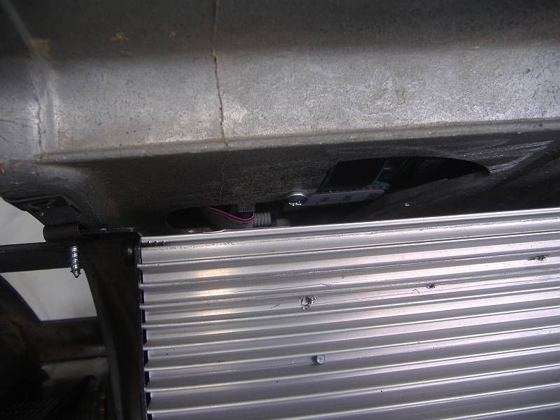

When I look at this idea I see a couple of problems, not saying they can not be over come but...
It is clear that some metal removal will be required in the shopsmith as part of some of the connectors are hidden. Second there is not a lot of room once the power supply is in place.
This is an attempt to show the space, while it doesn't do very much good it might help you to see what I mean.
[ATTACH]17919[/ATTACH]

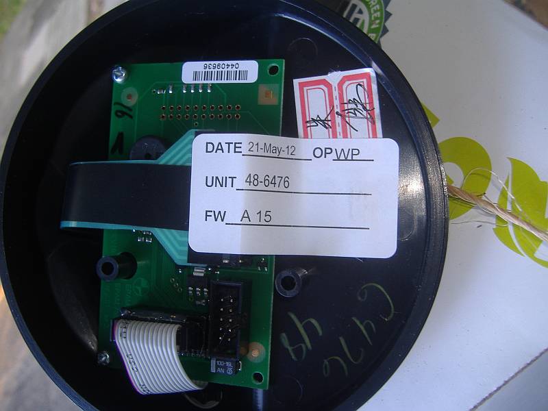

Here is a clearer picture of the shopsmith unit when it us unmounted.
[ATTACH]17920[/ATTACH]

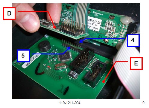

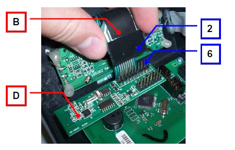

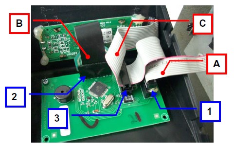

Now for those have not seen the upgrade from Nova take a look at these images taken for education purposes from there manual.
[ATTACH]17921[/ATTACH]
[ATTACH]17922[/ATTACH]
[ATTACH]17923[/ATTACH]
If you have more interest you might want to download the manual to read a bit more on the subject.
