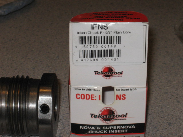

I am not a woodturner. I have not made a single wood chip using a wood lathe. I purchased my G3 from woodworkerspecialties.com (aka 23gauge.com) off the Internet as the price was really good. I normally purchase used tools. Well, I have two DVR motors, but that's another story. Anyhow, my G3 chuck came with a huge threaded adapter made to be used on a 1" threaded 8 TPI threaded shaft. I couldn't use it. I called the company and told me they would get the correct adapter to me. I learned this company is the largest seller of 23 gauge nailers in North America- pretty cool, huh? 23 gauge is the diameter of a Cat 6 Ethernet wire!
They called Teknatool in Florida. Teknatool is right down the road from my condo down there- a small world and I visited them a week ago. I received the chuck adapter marked IFNS- a 5/8" insert adapter which is labelled IFNS Insert Chuck F- 5/8" Plain Bore. Well everyone here knows the Shopsmith uses a tapered flat on their shafts. I believe there are other forum threads with G3 Chuck issues with the Shopsmith. I know without a doubt that any issue will be resolved, but not many people know Teknatool has a U.S. presence in Florida. They are wanting to help but not many know how to. Go to http://www.teknatool.com and you can get their phone number and other info.
I asked questions and found out there was a special chuck insert developed just for the Shopsmith that allows a user to use their 5/32" Allen wrench and it is properly sized. The first insert adapter was not manufactured to mate with the taper on the Shopsmith arbor.
So I've taken some pictures of the 3 different chuck inserts I have. You'll see three. One is a IDNS which is made to be used on a 1" 8 TPI shaft. Can't use that. This came with the G3 chuck package. I called and a replacement insert adapter was shipped to me.
The replacement 5/8" insert adapter is marked:IFNS Insert Chuck F- 5/8" Plain Bore. The set screw will not fit flat on the Shopsmith shaft because this set screw is designed to sit on a flat surface- not a tapered or angled one. On the hex surfaces, there is stamped an "F" on this IFNS adapter. This adapter is only 1 9/16" ( 134mm) long- slightly shorter than the correct Shopsmith adapter. The hex surface is narrow (9mm), just enough to hold a screw which Teknatool calls a grubscrew.
The correct Shopsmith insert adapter is 1.75" (144mm) long. It has a larger 5/32" setscrew (like all the other setscrews it seems in the Shopsmith) which is sits at an angle to allow the setscrew to perfectly mate with the angled taper on the Shopsmith shaft. The hexagonal flat surfaces on the Shopsmith adapter are more than double the width (19m) of the IFNS adapter which has the smaller metric set screw. The Shipsmith insert adapter is stamped with an S on one of the hex surfaces. Refer to the pics.
I have taken pictures and will attempt to post them. I have written Teknatool whom I was so impressed with during my visit to their U.S. facility in Florida, that I might just become a wood turner! I am not aware if anyone in Shopsmith Customer Service is aware of this issue. I did not contact them as I "cheaped out" to save a few dollars & regret not ordering from Shopsmith to begin with.
There are many unique features of the Shopsmith such as the width of the slot used for the miter gauge. However, the customer service I have received from everyone at Teknatool and woodworkerspecialties.com who also sells 23 gauge nailers has been outstanding and no less than the super people on Poe Avenue at Shopsmith in Dayton whom I've known for years.
I may have opened Pandora's box and that was not my intention. I have 11 Shopsmiths and I was looking to duplicate the method Bill Mayo (long-time forum member, machinist, and far more) uses to polish way and bench tubes. I subsequently learned I could of used a rubber engine freeze plug with just a drill, and a couple of other things. But I have trouble walking away from a good deal.
Tony

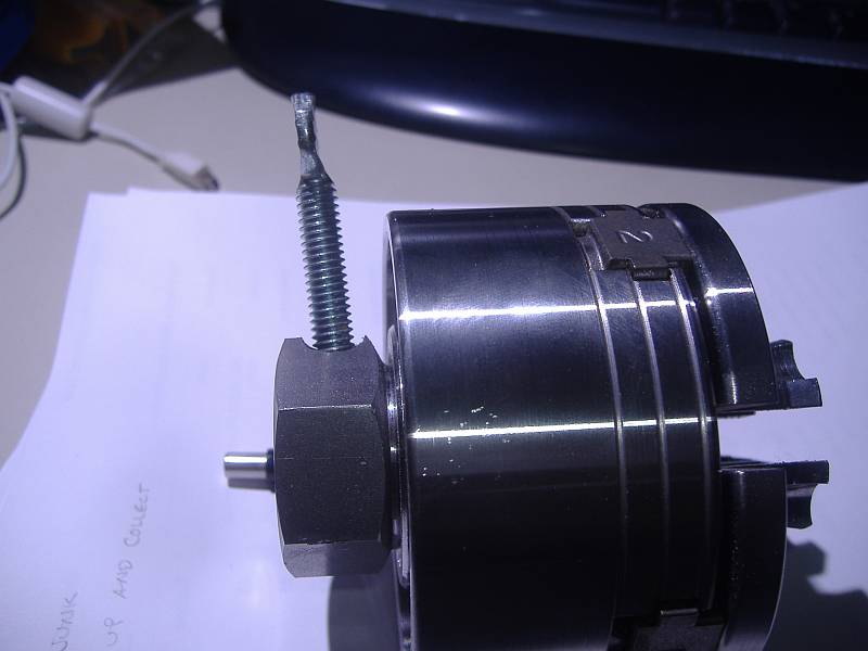

OK this caught my interest so out to the shop I go.
I purchased my G3 from shopsmith some years ago.
It has the correct size allen ie it works with the shopsmith t-wrench.
It has a 5/16 thread.
The hole is at the "shopsmith" angle.
The adapter has a "F" stamp.
The easiest way to check is to remove the set screw and insert a bolt, this checks the threads and the angle is really easy to see.
[ATTACH]18186[/ATTACH]
[ATTACH]18187[/ATTACH]
My adapter is also marked with an "F" but it differs in that the setscrew requires a 3mm allen wrench and the set screw is not at an angle to meet the taper correctly. It is at 90° to the shaft.
[ATTACH]18188[/ATTACH]
However, as always, Shopsmith customer service, in collaboration with Teknatool, has come through. Teknatool is sending to me a replacement adapter.

I have an older (original) Nova chuck with tommy bars with an "F" insert/adapter that uses the 3mm allen wrench. The threads are perpendicular to the flat surface of the insert/adapter.

dusty wrote:My adapter is also marked with an "F" but it differs in that the setscrew requires a 3mm allen wrench and the set screw is not at an angle to meet the taper correctly. It is at 90° to the shaft.
My adapter is the same as Dusty's. I bought it May 2011. I called Teknatool and they are shipping me a replacement adapt too. Here's the kicker: they advised me not to use the chuck again until I get the new insert. I suspect the angle of the set screw is the issue.
