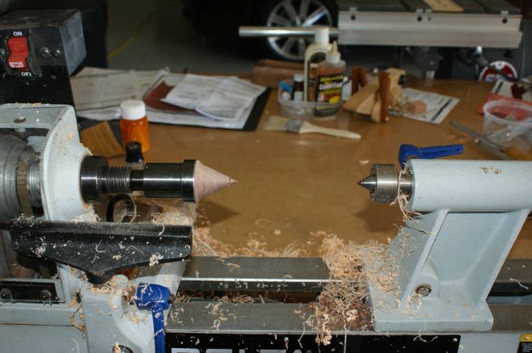

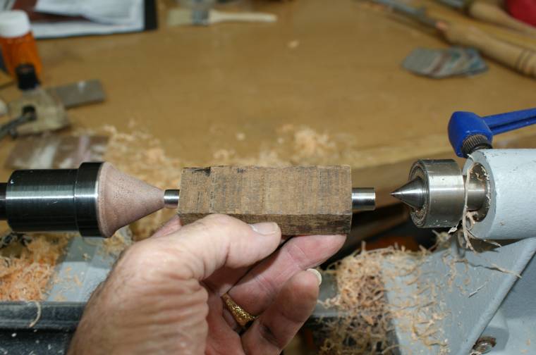

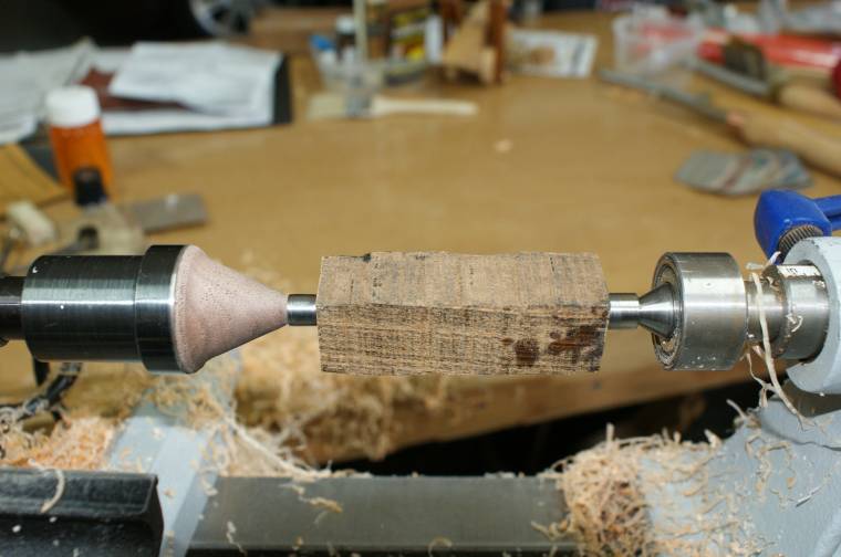

Just a couple of pics to show the SS components used on a Delta Midi lathe for pen turning. The tailstock is a 60 deg point live center from Sears a long time ago.
Just the basic setup

The pen blank and bushings. No mandrel!!
[ATTACH]19096[/ATTACH]
Ready to turn
[ATTACH]19097[/ATTACH]

I suppose I could go to the pen turning forums and get this answered, but I thought asking here might make this particular thread a little more complete.
I see the two 60° center and understand the friction drive (used a homemade jam chuck for a similar thing just a few days ago.) I see how everything is mounted up, sorta. What I don't see is how you align the brass tube and the bushings (which I understood to be the whole point of the mandrel).
Enlightment?? :eek:
wa2crk
Posts: 3080
Location: Leesburg, Fl
Post by wa2crk »
Fiatben;
When a mandrel is used there is some play at the end of the mandrel shaft where it comes into contect with the 60 deg center. The mandrels are always 7mm in diameter but the pen brass tubes can be a larger diameter and the bushings have a step in them that fits into the larger brass tube and the inner diameter of the bushing fits on the 7mm shaft. Because the pen mandrel is usually a fixed length bowing of the mandrel can occur and cause a pen blank to turn out of round. The mandrel can also be a problem when the mandrel nut is tightened causing more flexing of the mandrel shaft.
Penn State Industries has a mandrel saver that is a hollow tailstock center that the mandrel passes through and headstock pressure secures things against the mandrel saver. This adds another problem in that the mandrel saver has clearance to allow the shaft to pass through.
All of these clearances cause some vibration to enter into the system and can produce a less than optimum cut.
I was turning some acrylic blanks for some seam rippers on the mandrel setup and as I moved away from the headstock I started to get some vibration during the cut. I was using a EWT carbide cutter which is extremely sharp.
When I turned some acrylic using the friction drive there was no "buzzing" caused by the vibration.
In short eliminating the bushing to mandrel clearance and the clearance between the mandrel and the mandrel saver and at the same eliminating any possible mandrel flexing makes a much stiffer assembly for turning. The cone centers take up all the slack and things seem to turn much smoother.
Hope this helps. If not type at me some more.
