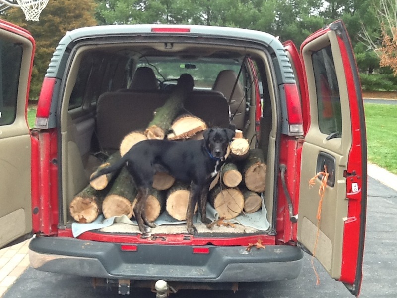

[ATTACH]19054[/ATTACH]
This thread inspired Harley and I. We passed this oak while running yesterday and picked it up this morning. There is no log larger than 12" in diameter, and they average about 40" long. The longest if 54".
What do I do now? Is it worth keeping for furniture? I do not know anything about getting this lumber into useable boards except I know it has to dry and my band saw table unable to deal with 100lb logs.
If I let it sit I expect it won't be any good for wood working. I have some Maple and cherry that was cut down in the spring that splits as it dries.
- oak.JPG (160.5 KiB) Viewed 2655 times

Question is, are those trunk pieces, or branches.
If branches, they may too 'stressful' to use.
They do look pretty straight.
If you decide to air dry them, seal the ends to minimize splitting.
Same if you make them 'boards' first.
bcone1381 wrote:These are all trunk pieces.
What do I seal them with?
What is the theory that is taking place that keeps them from cracking if sealed?
What do you mean by "Too Stressful"
What are the consequences of a "Stressed" piece of lumber?
I understand latex paint works.
As the ends dry faster than the 'innards', the shrinkage causes the splitting at the ends. By sealing the ends, drying takes place through the sides equally along the entire length.
A branch has gravity pulling against it. The result is the bottom side is larger(pith to outside) and the stress is there because of the torque etc. Once the branch is cut, the torque is gone, but the internal 'forces' remain.
As it dries, a 'stressed' piece will warp severely.
