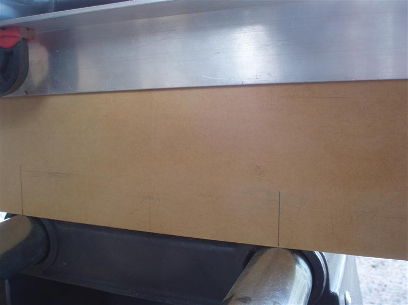

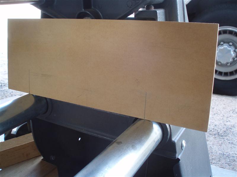

algale wrote:I am happy to do this but need to figure out a way to get precise, repeatable measurements (a process which is not as simple as throwing a ruler against the tubes). Let me cogitate on this ...
My tools for doing this are 1) a piece of 1/8" hardboard, 2) a piece of 2" aluminum angle, 3) a 6" ruler and 4) a spring clamp.
I clamp the aluminum angle to the bottom side of the way tubes.
I stand the hardboard upright on the top edge of the bench tubes.
I scribe a line on the hardboard at the bottom edge of the aluminum angle.
I measure the distance of the line from the bottom edge of the hardboard. Adding 2" to that measurement gives me the distance between tubes.
Prior to doing all of this I mark two lines on the bottom edge of the hardboard that are 8 1/2" apart. These identify the center line of the bench tubes. I also have the center line of the way tubes marked on the other edge of the hardboard. I take the measurements at the center line of the way tubes on a line perpendicular to the edge of the hardboard..
[ATTACH]18238[/ATTACH]
[ATTACH]18239[/ATTACH]
- Tools 001 (Custom).JPG (47.22 KiB) Viewed 2870 times
- Tools 003 (Custom).JPG (38.96 KiB) Viewed 2871 times

Dusty,dusty wrote:al: It appears that you have that tube alignment about as close to perfect as you can get. It will likely change some when you roll the Mark V around the shop but not enough to alter critical alignments.
I would sure appreciate it if you would measure the vertical separation between way and bench tubes at all four corners. I am curious to see if they are even close to consistent. Mine are all different and differ by as much as 3/8".
Sorry for the delay in responding to this request. The distance between my bench tubes and way tubes appears to vary by no more than 3/32nds. From the bottom of the way tubes to the top of the bench tubes, I get the following:
Left Infeed: 5 and 28/32nds
Left Outfeed: 5 and 26/32nds
Right Infeed: 5 and 25/32nds
Right Outfeed: 5 and 25/32nds
Incidentally, it occurs to me the leveling screw on the left outfeed side could easily effect these measurements. On my machines, that leveling screw is totally below the surface of the headrest casting and the twist is currently 0 degrees per my Beal. Since the error on the Beal is 0.1 degrees, I probably could raise the leveling screw on the left outfeed side the 2/32nds required to make the distance between the tubes on the left end equal on both in and outfeed sides and still read 0 degrees twist.
