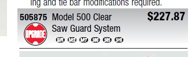

I don't think the safety grip was a standard item back then (?) - my '78 didn't come with one when it was bought new. Easy item to find on E-Bay however and definitely a worthwhile upgrade. Rip fences are readily available there as well. Don't forget you'll need the upper and lower saw guards as well - the upgraded ones are a lot nicer than the original all metal ones...I'm assuming the upgraded one will fit this era machine as well.

The saw guard(s) and the safety grip were extra cost options. All the other stuff in Ed's post is appropriate.
The 'newer' guards will require drilling/tapping holes in the trunion.

Other "catalogs" are also available via download as pdf's and that can also help as somethings have the models shown and the ones that will not work are "/" ed.
http://www.shopsmith.com/ownersite/index.htm
from the accessory catalog

The ultimate answer is to call in your order and check with the knowledgeable sales staff.
