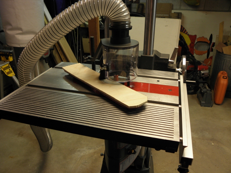

So I began yesterday in above table routing. I first installed the table insert that I had made the previous day.
I quickly realized that I had no guide pins, so I used my router insert with pins and dust collector underneath.
That worked pretty well. Adequate dust control.

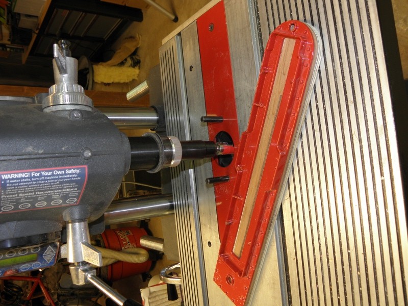

I next switched to undertable routing. I would have the same problem with my homemade insert, but I first installed it to see how things lined up. I failed to take a photo, but I had bored a 3/4 inch hole with the drill press, and my 3/4" router bit fit right through. Pretty outstanding alignment!
I switched to the router insert, and realized why I had so much trouble the previous day. I'm very new to table routing, and didn't realize that I was using a plunge router bit for table routing.
Above routing - homemade insert.jpg (174.94 KiB) Viewed 3733 times

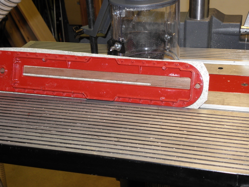

Above routing - pin routing.jpg (181.23 KiB) Viewed 3723 times
Undertable routing - improper bit.jpg (299.3 KiB) Viewed 3720 times

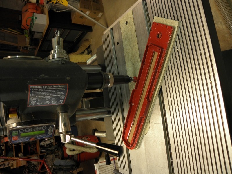

Undertable routing - down surface of pattern.jpg (323.38 KiB) Viewed 3719 times
