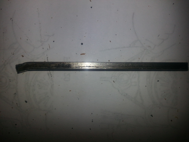

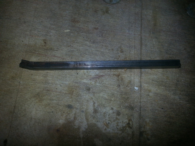

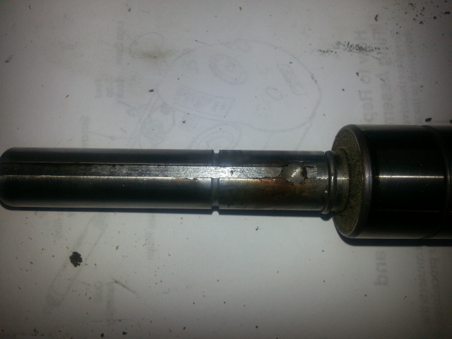

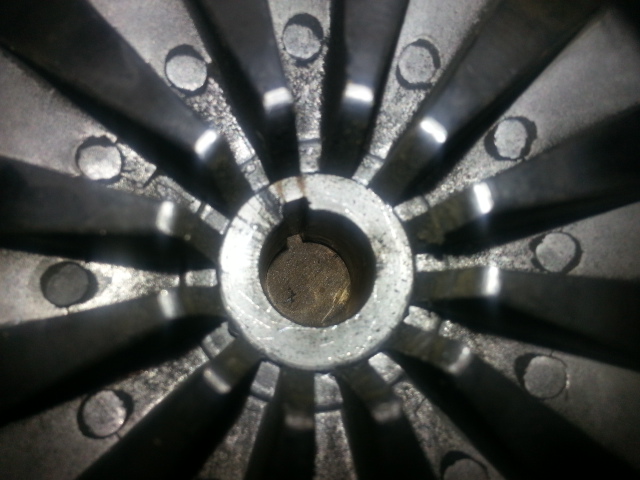

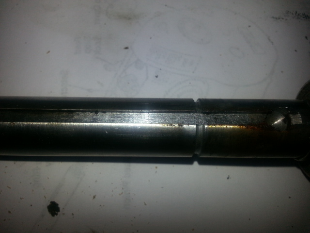

here are some pictures of the idler shaft and control sheave. There was a very minute play in the shaft withe the sheave. This minute play is the only thing I could find that might be causing the click.

I'll add 2¢ from a different place. Since your keyway and short key seem to be in good shape, maybe the slack in the drive belt and click noise are related to a take-up in the drive belt as the motor begins to turn.
Sometimes the motor sheaves present a problem that seems to be coming from the control sheaves or the speed control assembly. The lubrication of the motor sheaves is sometimes the solution. It is hard to get enough oil through the little hole in the motor shaft slide.
Try this - it sure won't hurt anything but will help even on any machine. With the drive belt off the outside motor sheave should be in high speed position. Raise the unit to vertical drill press position and lock in place. Oil the entire shaft through the spring. Let the oil seep down the shaft for several minutes. Then lower the Mark V to horizontal and Oil the entire motor shaft again - followed by hand pulling the outside sheave outward several times, until it slides smoothly.
