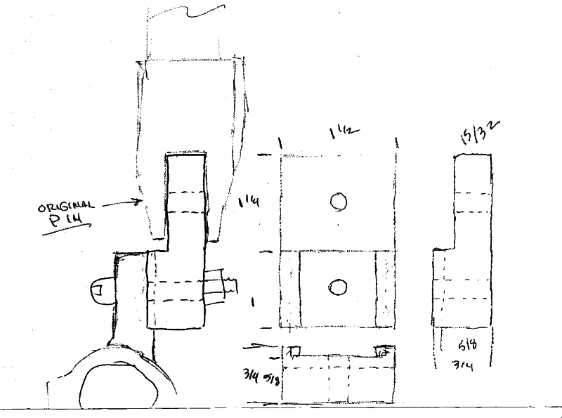

5/8" adapter
Rough sketch but I think it would work.
[ATTACH]20248[/ATTACH]
