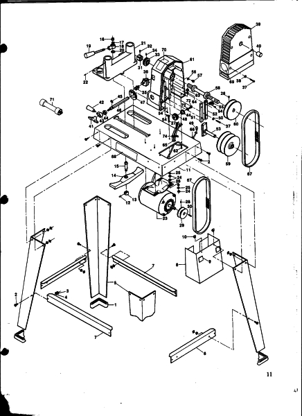

This one?
[ATTACH]25082[/ATTACH]
I replaced 51,52 - not 53.
From your comments, I am now suspicious of 72,73,44. IIRC, I thought 44 was 'extra'(did not belong there). I now think it was the wrong part. What does yours look like(44)?
- power station exploded.jpg (101.82 KiB) Viewed 3502 times

JPG40504 wrote:Run it with the cover off. The shaft flops from front to rear, The slide 'tenon' is smaller than the outer rails. I have only observed the first one, and it was 'reassembled' by the po from a pile of parts. Extra/missing parts etc.
Our favorite SS CS person refers to the slide parts as 'very sloppy'. Gotta give him credit, the new parts did not improve things much.
Is it the Rack and Shaft (56) moving back and forth between the Left Guide (54) and the Right Guide (55) that you are referring to? If so, we have some differences. There does not appear to be any adverse movement of that part in either of my machines.
The visible vibration that I see (when the machines is the noisiest) is in the sheaves and that tames down some when the speed changer is locked. My belts also "flop" more than I would like and this seems to be directly related to level of noise.

JPG40504 wrote:This one?
I have not been out to look at the machine but is #44 not functionally similar to a wedge lock and comes into play when the speed change control lock is applied? In my parts list this is called a bushing.
