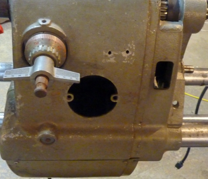

Post by markflow »
Here's the picture.
markflow wrote:Here's the picture.
Tis a Mark 5 Gilmer 'Greenie'. Definitely an old one, but not a Mark V.;)
It should have a 3/4 hp motor.
Did the motor have a start 'relay' mounted on the back end?
Do you know what brand the motor is? It may be a Franklin, A GE, or an A.O.Smith(?).
Did you find an oil hole on the control sheave hub and the floating sheave hub on the motor shaft?
Since the motor runs 'coolly' with belt off, and the shafts turn freely, we have a mystery.
At this point I would hook up the belt again and start over. The older models came with a recommendation to always turn the speed control down to slow prior to turning the power off. That shortens the time it takes the motor to start when turned on. Manually set the speed control to slow before starting it up.
It is possible that a combination of 'details' led you to the breaker tripping.
The following is a list of some of those things.
Breaker defective.(overly sensitive to trip)
Shopsmith NOT the only thing fed by the breaker.
An extension cord between the receptacle and the power cord.
Motor start switch or relay not connecting/disconnecting start winding.
Excessive mechanical load.
Poor connection of the power cord plug to the recepticle.
Motor internal loose/poor connection.
Power switch not making properly.
i.e. anything that restricts power at startup and anything that prevents the motor coming up to speed rapidly and anything that prevents the motor start circuit from kicking out once it is running.
This is not an exhaustive list, but the more likely culprits.

Hi the motor is a A.O.Smith and had the started switch checked and it was working properly....going to try and change the breaker and then the power cord and then the switch to start with ....thanks everyone for the info this is definately an awesome site :) and yes its a 3/4 hp and it does have the start relay on the end :)
markflow wrote:Hi the motor is a A.O.Smith and had the started switch checked and it was working properly....going to try and change the breaker and then the power cord and then the switch to start with ....thanks everyone for the info this is definately an awesome site :) and yes its a 3/4 hp and it does have the start relay on the end :)
If it has the external start relay, then there is no start switch.
The start relays can be somewhat unreliable as they age over a half century.
Tis possible that the relay was not 'picking' and opening up the start circuit when the motor was overheating.
Keep stopping/starting the motor at a slow speed setting(assuming it then will run without tripping the breaker).
If you were hearing a click when starting or stopping, it was the relay making the click.
Are you sure it is is a 'relay' on the end? pix time again!!!!
The GE motor were the ones with a start relay usually.
The A.O.Smith motors I have seen have a start switch housing on the back end.
