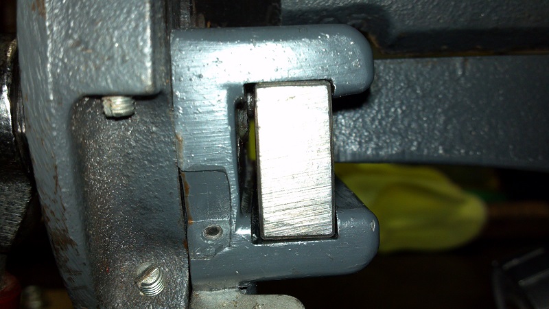

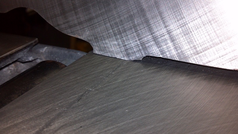

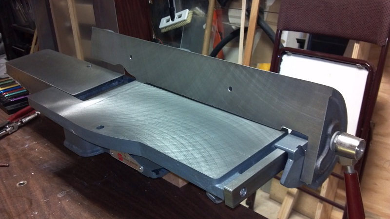

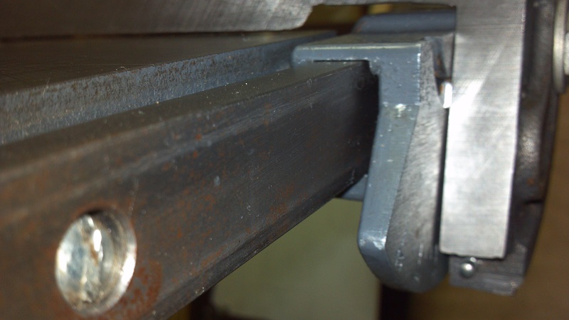

Finally started joiner re-assembly this week.
[ATTACH]21665[/ATTACH]
[ATTACH]21666[/ATTACH]
Assembly when very smooth and easy. Now, with the fence quadrant, that was a different story.
When I locked down the lateral adjustment (quadrant to fence mounting bar), the fence rose about 3/8 to 1/2 inch proud of the infeed table!
After searching past threads dealing with this issue, it was obvious that the quadrant was bent.
Well, took the quadrant and mounting bar to work with me today. Used the 20 ton press and put er back in shape. A little fine tuning with a small flat file finished it off. I left the fit kind of snug but moveable.
[ATTACH]21667[/ATTACH]
[ATTACH]21668[/ATTACH]
[ATTACH]21669[/ATTACH]
After re-attaching the bar, quadrant, and fence, I now have no lift on the far end of the fence. Right or wrong, it's far better than it was.
Make mental note....another SS step to observe when done with the Jointer...unlock lateral fence adjuster! May very well allow the quadrant to last longer before another rebend. :D

I think keeping the gorilla off the handle will suffice!;)
pieceseeker
Posts: 370
Joined: Mon Jan 07, 2013 12:13 pm
Location: Lawrenceville, Georgia
Post by pieceseeker »
Yea, I know about gorillas. We have a few at work when they're using the brake lath. Things just don't need to be that tight!
I believe that the gorilla is getting a bum rap. I too have had a deformed quadrant and I do not crank down hard on the locking handle and never have.
BTW, your jointer looks to be brand new except for some scratches where the fence rides.
dusty wrote:I believe that the gorilla is getting a bum rap. I too have had a deformed quadrant and I do not crank down hard on the locking handle and never have.
Very likely since I also consider the soft aluminum to be a deficiency in the part. That said, I also think a conscious effort to resist over tightening it will go a long way to prevent the back opening up.
I know in the past I have acted like a gorilla with that clamp. No more!!!!
