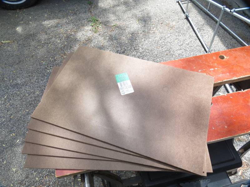

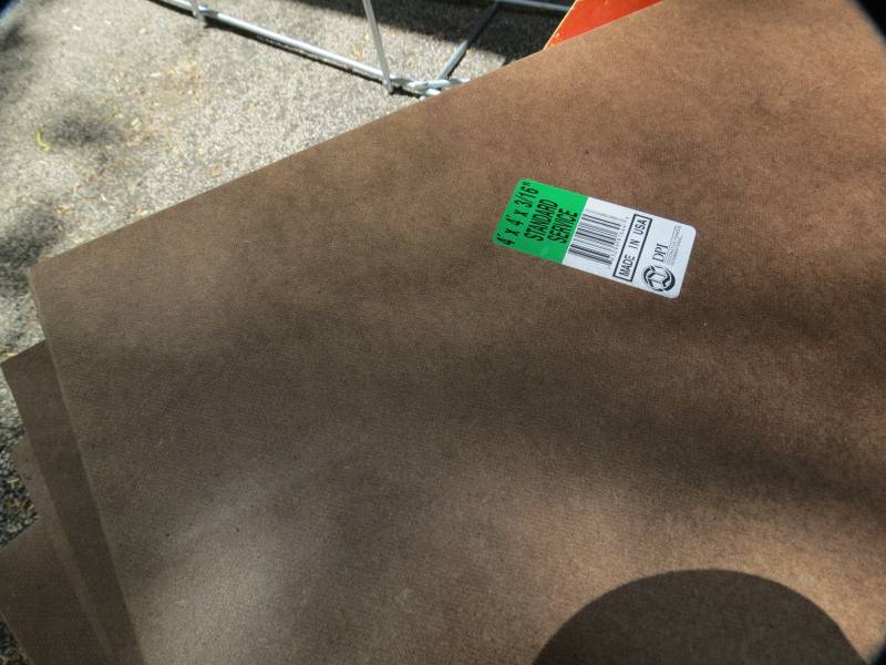

Got a 3/16" x 4' x 4' sheet of this material
[ATTACH]22011[/ATTACH]
This was my first project with it so it is a learning experience. Like other products like this it is stable and flat and cheap so that sound like a good thing to make some lids/tops for the storage boxes. I cut the 6 parts out, you can see 5 of them here.
[ATTACH]22012[/ATTACH]

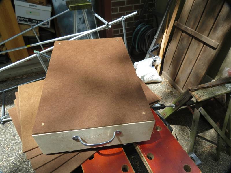

Keeping in mind this is still a simple build I went with 1/4" dowels cut to 3/4" long and drilled and put the dowels in. I left some wiggle room so they are easy to take on or put back on. I did one to make sure my setup was right and then did the other 5.
[ATTACH]22013[/ATTACH]
[ATTACH]22014[/ATTACH]
Looks like is going to work good. I have two tops to build yet, just cutting and putting the dowels in so I should be finished in another 10 minutes or so.
