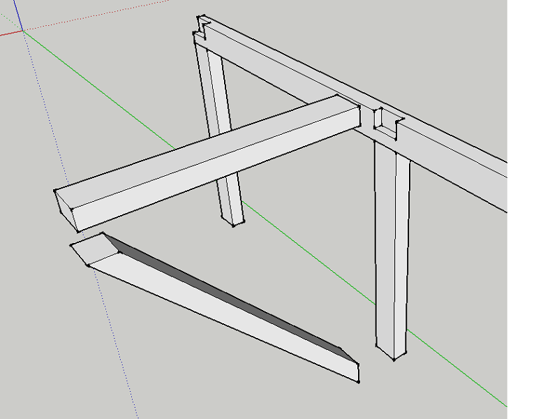

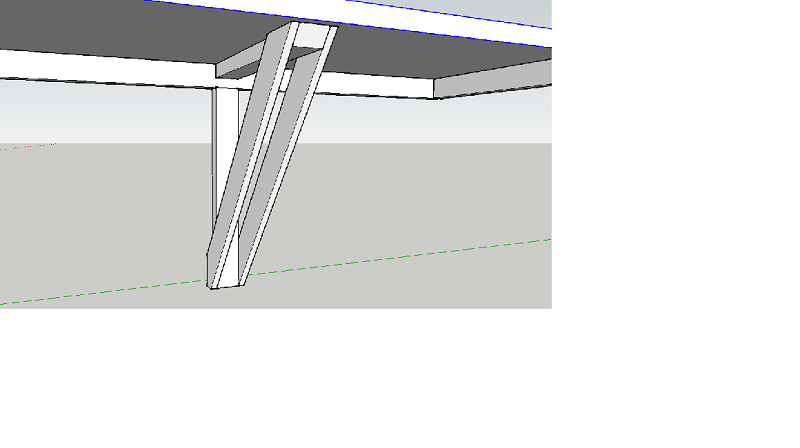

After many delays (trips to visit family, weekends spent working on vehicles rather than making sawdust, etc), I'm just about at the point where I can start adding my finish to the desk surface. So I've been putting a lot of thought into how I'm going to install this thing.
One of our desires is for under the desk to be as open as possible and I'm trying to balance that desire with having adequate support. I have very little experience building cabinets (just a shop cabinet) or anything like that. With my material change from plywood to lumber, I had to redesign the supports. I came up with this triangle system.
I'd really like some input and feedback on my plan and design. What changes should I make? Is there a better way?
My current plan is for a horizontal rail screwed to the wall studs. Vertical braces help provide support. Notches in the rail accept the top part of the "triangle" brace. The hypotenuse of the triangle supports the front of the desk diverting the force against the bottom of the wall.
I have these t-nut like things, except instead of being pronged they have outside threads and screw into the wood (instead of "nailing" in with the prongs). In my experience and testing, these things hold exceptionally well. I'll use three of these, installed in the underside of the desk surface at each top "triangle" brace - one at each end, and one in the center. The bolt holes in the braces will be slotted in the center and front (opposite the wall) to allow for movement.
[ATTACH]22752[/ATTACH]
[ATTACH]22751[/ATTACH]
- Under Desk 2.png (91.14 KiB) Viewed 1307 times
- Under Desk.png (71.28 KiB) Viewed 1305 times

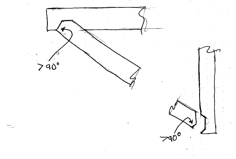

I would consider shaping the 'hypotenuse' brace ends as below.
[ATTACH]22755[/ATTACH]
Having the indicated angles greater than 90 ° makes the brace 'captive' with any vertical load on the top. The opposite 'corner' is truncated merely to reduce the required depth. This provides load bearing surfaces on the ends of the brace.
P.S. the braces need not extend all the way out to the end of the 'top' 'cleat'.
- brace end shape.jpg (56.39 KiB) Viewed 1296 times

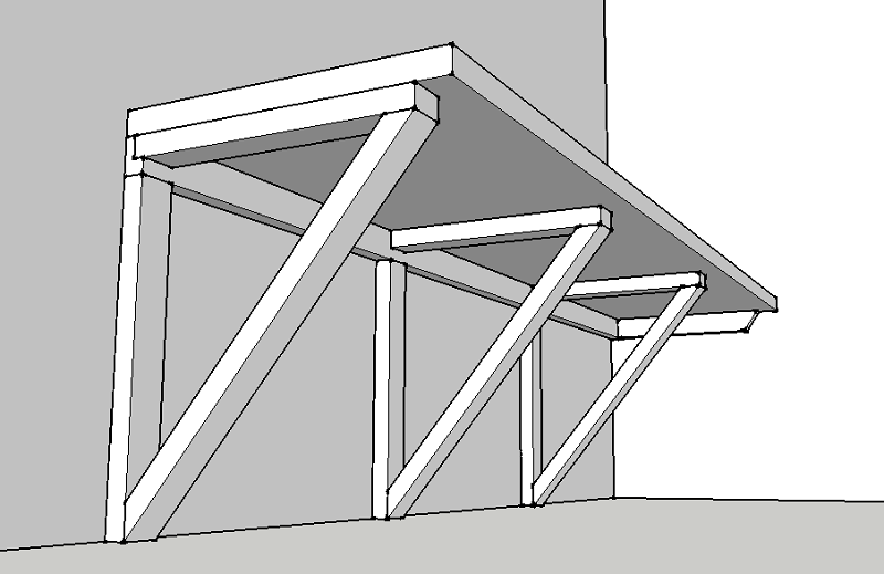

That is a great idea, JPG. I'm going to have to ponder that because I really doubt my skills to do that accurately...

Two cross cut bevels and a dado.heathicus wrote:That is a great idea, JPG. I'm going to have to ponder that because I really doubt my skills to do that accurately...
[quote="JPG40504"]Two cross cut bevels and a dado.]
It's not the mechanics of making the cuts, it's making the assembly accurate enough! I could just see myself cutting the diagonal brace to fit the cutouts perfectly at each end, but being 1/4" short. Or my wall may be out of square (I haven't even checked that yet) making the triangle not exactly a right triangle making all the joints be just a little off. I'm just thinking too much can go wrong and I'll be fighting with it all day. I think I want to try something a little more simple.
So, how about this?
[ATTACH]22768[/ATTACH]
I could clamp the diagonals to the horizontal and vertical braces, make adjustments so they are all square and level with one another, then screw them together (drill pilot holes for the screws, then take apart, add glue, and screw back together).
So, how about this?
- Under Desk 3.png (39.42 KiB) Viewed 1272 times

A decent plan! An improvement over the first 'pix'!heathicus wrote:It's not the mechanics of making the cuts, it's making the assembly accurate enough! I could just see myself cutting the diagonal brace to fit the cutouts perfectly at each end, but being 1/4" short. Or my wall may be out of square (I haven't even checked that yet) making the triangle not exactly a right triangle making all the joints be just a little off. I'm just thinking too much can go wrong and I'll be fighting with it all day. I think I want to try something a little more simple.
So, how about this?
