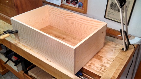

I am building a box for my son and daughter-in-law to set their flat screen TV on so the sound bar in the front doesn't interfere with the view. To match the coffee table it will be painted black. I decided to make the box with 1/2" stock (to cut down on bulk and weight) with dovetailed corners and an open bottom. I will rabbet recess a 3/4" top so it fits down and in about 3/8". Here is a picture before cutting dovetails:

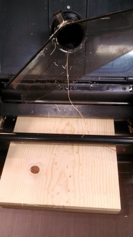

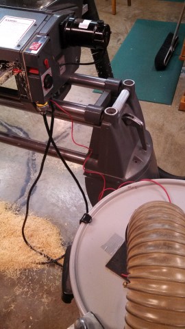

Now, when planing this wood I decided to attach a wire (the red wire) from one of the hex head nuts threaded into the front cross bar to discharge static from inside the planer to my collection barrel that is connected to my 4" system. The action of the blades hitting the wood charges the surface and the base plate to a high degree, especially with the house humidity at 22% (it needs to be lower on these really cold days).
[ATTACH]23669[/ATTACH]

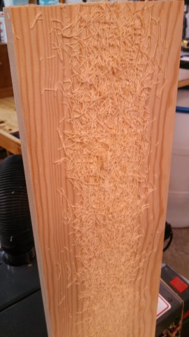

No success, as you can see by one of the boards set vertically. There is so much static on the surface of the board it will not drop the shavings from the surface, nor allow an efficient pick-up of them by my vacuum system. I have to use my hand to dislodge them after each cutting.

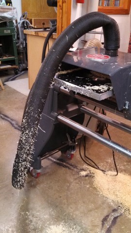

In this picture you can see shavings standing-up on the 2 1/2" hose.
[ATTACH]23671[/ATTACH]
So I wrapped the 2 1/2" vacuum hose with bare copper wire and ran it into the planer so it would drag the surface of the wood while planing. I would say it was at least 50% better. I think it could be greatly improved with a brass or copper brush attached across the black crossbar and the collector wire. It could then brush the entire surface of the wood for static as it exits the planer. Anyone got any ideas out there where to find a 12" potential collector brush? I know I could make one out of aluminum foil, and might yet try that today.

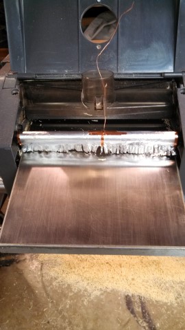

After I posted this morning it was back to the shop where I made an aluminum foil "brush". I folded the foil over three times and used a razor knife to brush the edge, then attached it to the cross bar using copper foil tape. I attached the collector wife to the foil. Drum roll......it works.
[ATTACH]23673[/ATTACH]
