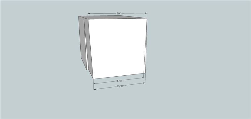

Would it be like farmer said and make the seam on the top edge tight while having a little wiggle room on the bottom?dusty wrote:His plan does say 23/32" but a 2° bevel on each side with a 3/4" top surface results in 47/64" bottom surface.
Big deal! A 1/64" difference (on each piece). What's 1/64" here and there.

Okay my swimming head is confused now. Wood ya knot want to cut off 23/64" off each side? Which wood be a result of 46/64(23/32)" bottom? I think I'm with Farmer in what am I missing.dusty wrote:His plan does say 23/32" but a 2° bevel on each side with a 3/4" top surface results in 47/64" bottom surface.

I will attempt to explain from whence I have been coming with my earlier 'comments'.
First the dimensions of the trapezoid. With a top width of 3/4" and a height of 3/4" and a bottom width of 23/32, the amount removed from each side at the bottom is 1/64". From that I say the fence need be 47/64 from the blade for both passes(saw or disk). The tilt is set so that exactly 0 material is removed from the sides at the top.
Assuming the dimensions given are correct, the angle of the bevel is not 2°, but 1.19°
I am not very good with chords, but I notice Dusty is doing quite well with sketchup(wonder what radius he is using) but his heights are over an inch too high. Wonder what using 1.2° rather than 2° would yield.

Geez Beeg you are making MY head spin!beeg wrote:Okay my swimming head is confused now. Wood ya knot want to cut off 23/64" off each side? Which wood be a result of 46/64(23/32)" bottom? I think I'm with Farmer in what am I missing.![]()
Starting with 3/4"(24/32) stock, if you remove 23/32 off one side, you are left with 1/32. Let's assume you meant to set the fence at 23/32(as EIT stated) you would be taking 1/32 off the bottom. Flip the workpiece and you remove 1/32" from the other side. Thus you have removed 1/32 + 1/32 = 1/16" from the bottom making the new width 11/16.
Setting the fence to 47/64 takes 1/64 off each side = 1/32 yields 24/32 - 1/32 = 23/32.
What Farmer was 'missing' is why all the complicated gyrations to cut a simple equal sided trapezoid.
But, if you take a 2 degree bevel off only one side of a 3/4 x 3/4 what do you have?
[ATTACH]24119[/ATTACH]
Which one is correct? One side beveled or two sides beveled???
- 2 degree bevel (Custom) (2).png (22.44 KiB) Viewed 1125 times
While y'all are flipping the bottom width setting around in yer noggin, remember the top needs to be 3/4"(angle dependent). I do not think '2°' will get that.

Try two sides beveled at 1.19°.dusty wrote:But, if you take a 2 degree bevel off only one side of a 3/4 x 3/4 what do you have?
