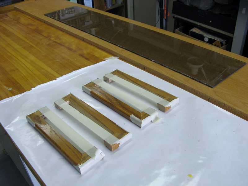

Tapeing corners
Post by STB »
shipwright wrote:A couple of solutions:
I use hot hide glue and assemble all four corners at once with masking tape, no clamps necessary. A fraction of a degree here or there is lost and they look perfect and are extremely strong.[/url]
Yesterday I tried using tape to hold and glue mitered corners. Works! Thanks for the tip. :cool:
[ATTACH]24199[/ATTACH]
