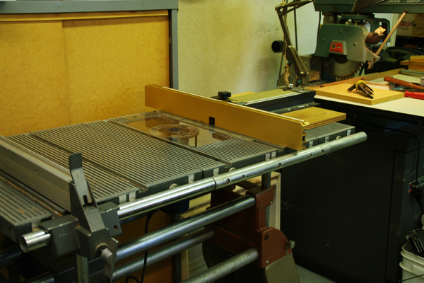

I thought if I could maybe get one in a reasonable amount of time I might order it, install and sell the whole setup. Give me something to do!! Saw dust is a no no even though I have respirators, shop dust filter etc. Spent the morning converting a 510 main table into a below the table router setup complete with a see through insert.

Hey Don, any chance of a picture of the router table?
Thanks.... Steve

Second the motion.........I too would like to see that photo! I have a second 510 main table I am thinking of converting to a router table.

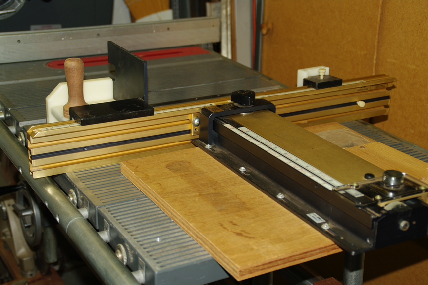

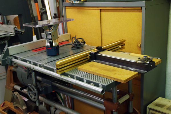

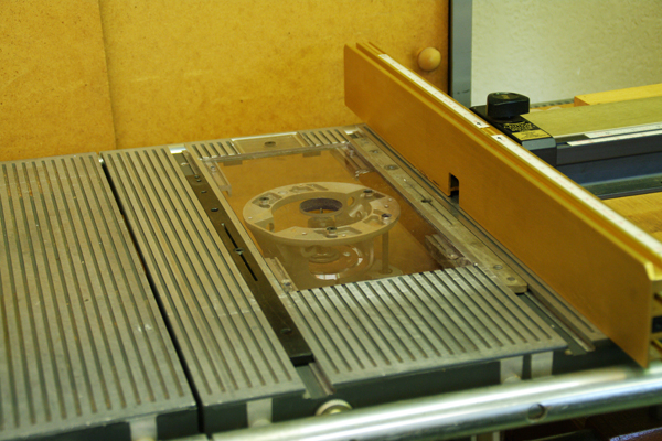

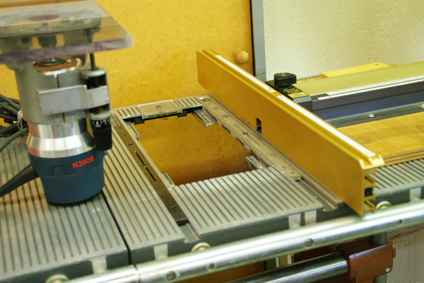

Here they are! Hope they help.
Hold the ctrl Key down on your computer and roll the wheel on the mouse to enlarge or reduce. You can also hold it down and use the + and - keys.
Don G

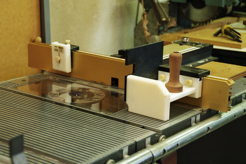

Here are a couple more!
Don G

Nice job, Don! How do you like the Jointech IPM? I have the newer version of the Jointech Saw Train that drops down on the 520 rails. It is a neat tool.

Rob
I really like it. I have used this fence system for several years making dovetails and etc. I have used it with the SS table saw except on bigger stuff fearing a little flex. It also works quite well on the DeWalt radial and Delta drill press. I have the same set up using a work station panel but wanted to make one using SS components. The insert is 1/2 Lexan, don't recommend using Plastic poly carbonate. The leveling screws are 10-32 Phillips. Also made insert for my Porter Cable plunge router however it doesn't have the above table adjustment like the Bosch.
I thought about making some brackets to attach to the fence to ride on the table tubes similar to the drop downs on the 520. Not too hard but haven't had a situation where I felt it was necessary yet. But it would make for a more positive cut.
