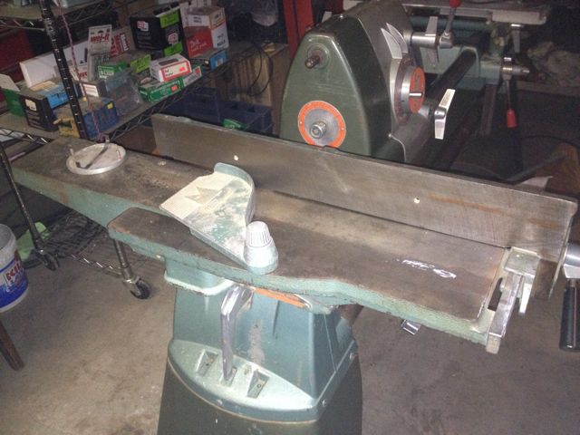

Mostly what I intend to do is replace the old cord and switch wires, clean and wax everything, and check for lube points. It starts, but it blew the breaker on the power strip, so the wire is definitely old. Hope that is all. The belt feels like a v belt, so I don't know if it has been upgraded.dusty wrote:You say that you are going to "tear into" your new machine. The only advise that I would give at this point is "don't fix it if it ain't broke".

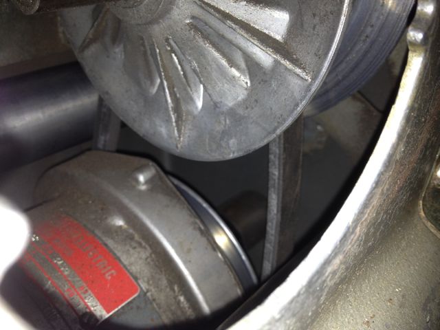

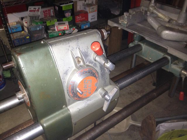

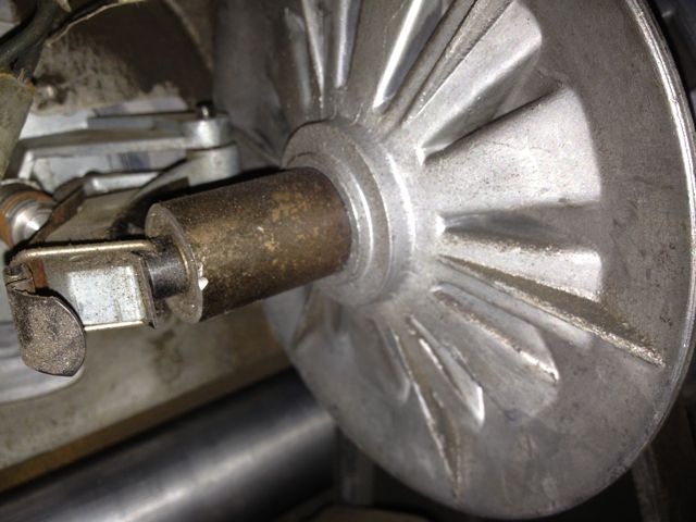

OK. Maybe this attempt to post pics will work. Tried with tablet and phone, no dice. Medium size jpgs may do it. Looks like a GE motor with a decent condition belt not unlike a fan belt. However, the back of the belt touches the steel glide tube or whatever they call the two bars on which things glide back and forth.
It uses a lot of juice starting up no load, so definitely needs a new cord. I think I will go with 12 gauge after all.

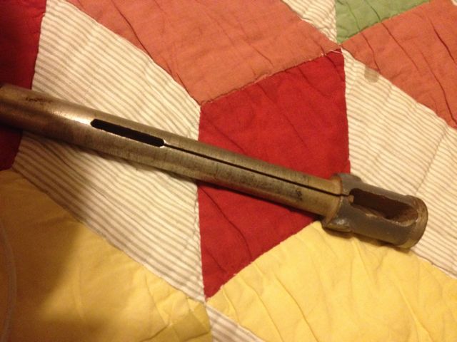

I identified all the parts except the shaft in the last pic. Any idea what this is?

Not surprising a power strip breaker tripped. The startup current will be large. Any resistance will increase the startup time(not a good thing). The wire has nothing to do with the breaker tripping.
All /Mark 5/V have a v-belt from the motor to the idler shaft. The 'different' belts are the gilmer or poly-v belt that connects the idler shaft to the main shaft.
The mystery part is something 'extra' that I do not think is a SS part.
The v-belt should not rub against the way tube unless the tension is 'loose'. That could be caused by a floating sheave being 'stickey'.
This site has a 800W x 600H limit(both must be less than those limits).
The 3/4hp motor does take time to startup if the speed control is set to a fast setting.
I assume you know to NOT adjust the speed control without the pulleys rotating.
