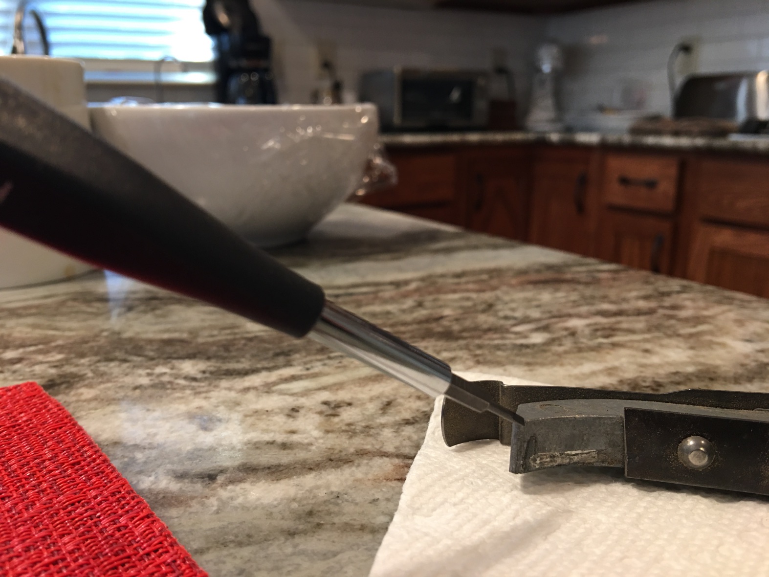

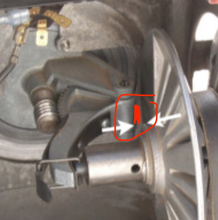

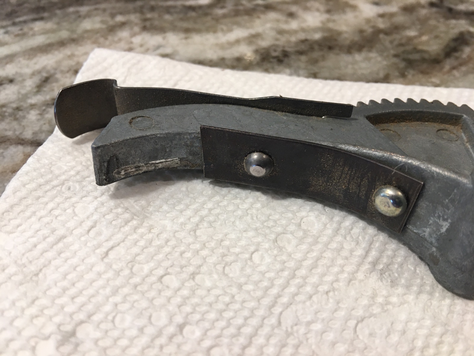

Re: Speed Control and Frightening Noises
I recently purchased a Mark V 510 that made a grinding noise once speed was increased around Route Shape.
Found the top half of the steel slide on the quadrant for the sheave bearing button to ride on missing. This allowed the ribs on the back side of the sheave to contact the quadrant at the hinge area.
Still waiting for SS to deliver the quadrant but I'm sure replacing it will solve my problem..
